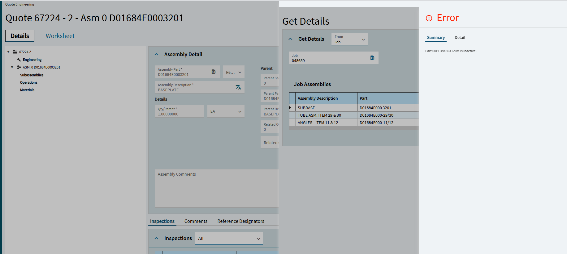

Hello,
Wondering if there is a way around this error? In Epicor 9 we would get the error as well but it still pulled details. It seems Kinetic gives you the error but does not allow the details to be pulled. Now we have to rebuild all the details manually. Kinetic is really killing our efficiency.
I don’t know, but MRP does the same with BOMs - if any component is inactive, it tanks the whole job. It’s been that way as long as I’ve known (back to 10.1).

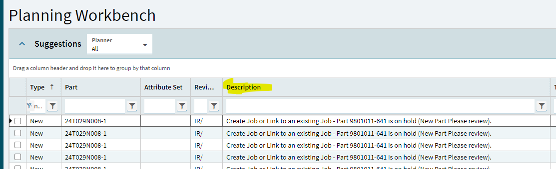

Any Part MRP cant create a job for should show up on the Planning Workbench to review. It typically tells you why it cant create a job too.
In our case we put new parts on Hold to allow people to get all the part setting correct before using it.
