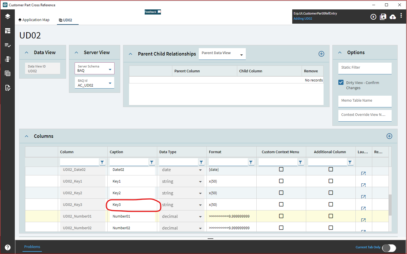

I am working on copying this concept to the kinetic version, however I am unable to pull the data into the text field. Key3 on the UD02 table is equal to the XCustPart in CustXpartref table, however I am not sure how I can pull that data into the text field, allow people to edit it, and save to the table once the customerXpart is saved.

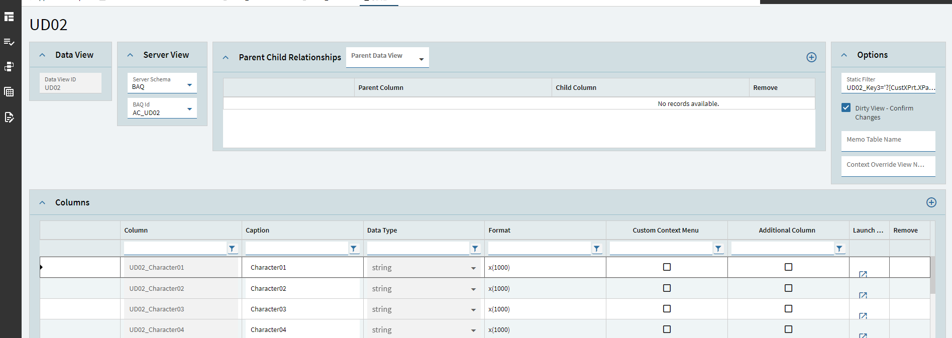

Dataview, I am pulling from a BAQ seemed like the simplest way, but I can pull from the Ice service im sure:

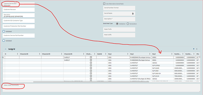

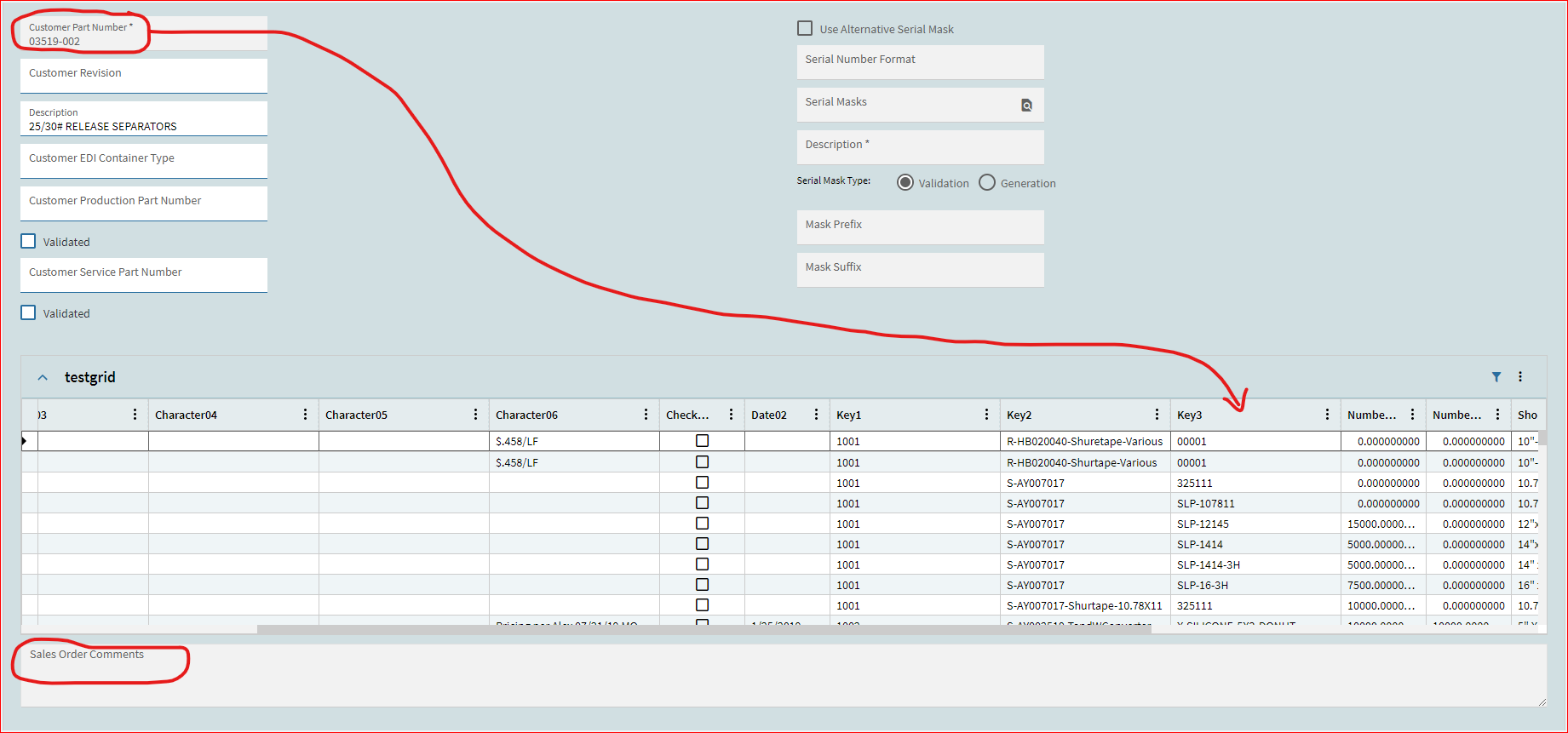

Then here is the grid I got working, and the sad and empty field that I cant do anything with just yet. The field’s epbinding is set to UD02.UD02_Character01.

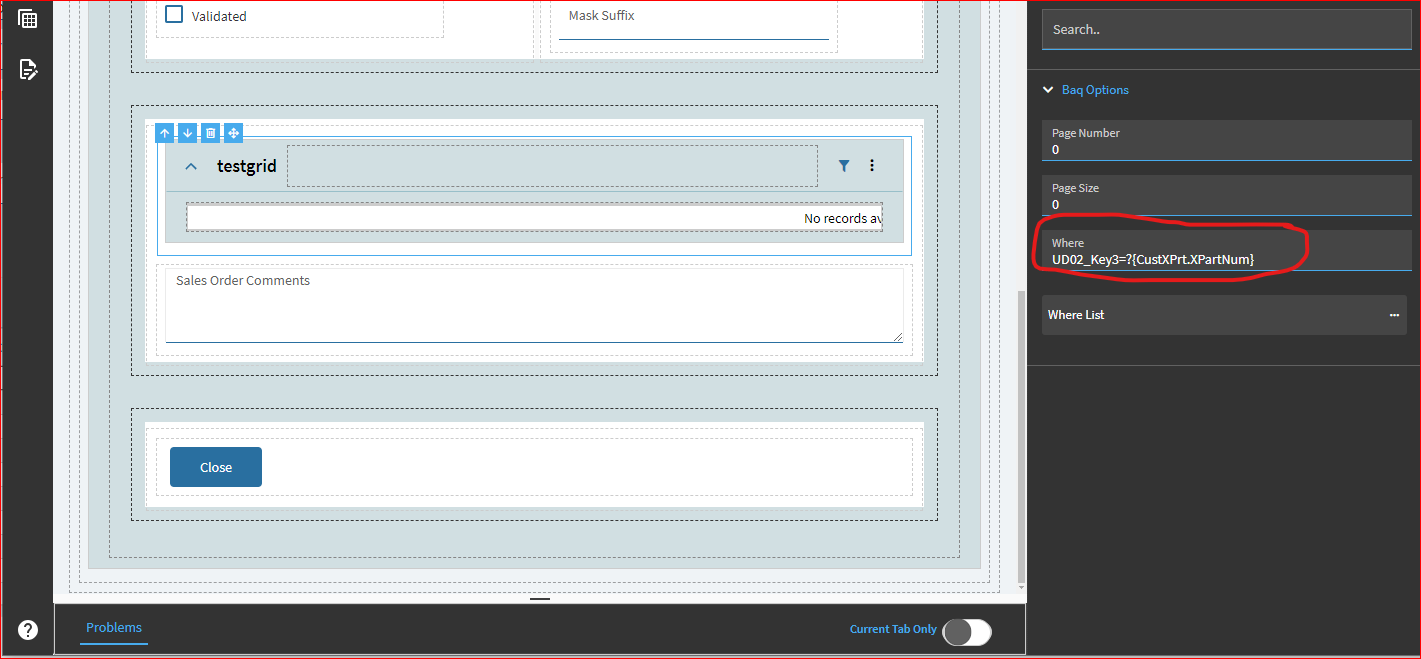

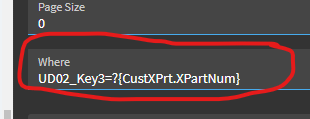

And last but not least, here is the filter I am trying to apply. I feel like it is applying just after the page loads? I have it set under the BAQ options of the dataview and the grid but no luck actually filtering any data.

You probably need single quotes in your Where clause.
UD02_Key3 = '?{CustXPrt.XPartNum}'

Took a second to load my change but that filter worked thank you!

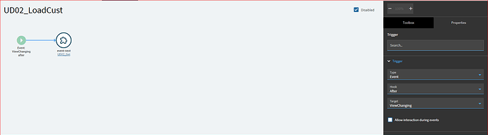

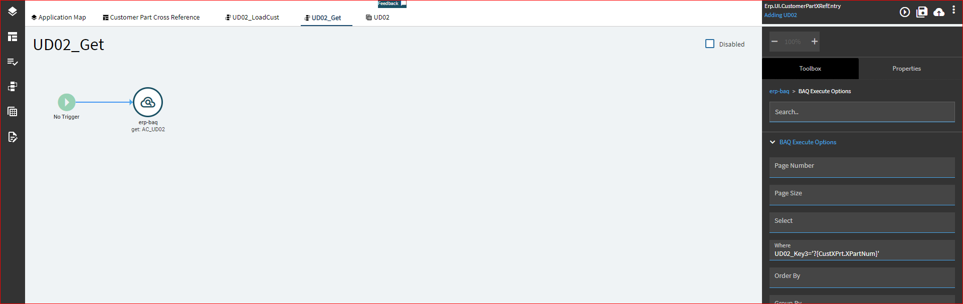

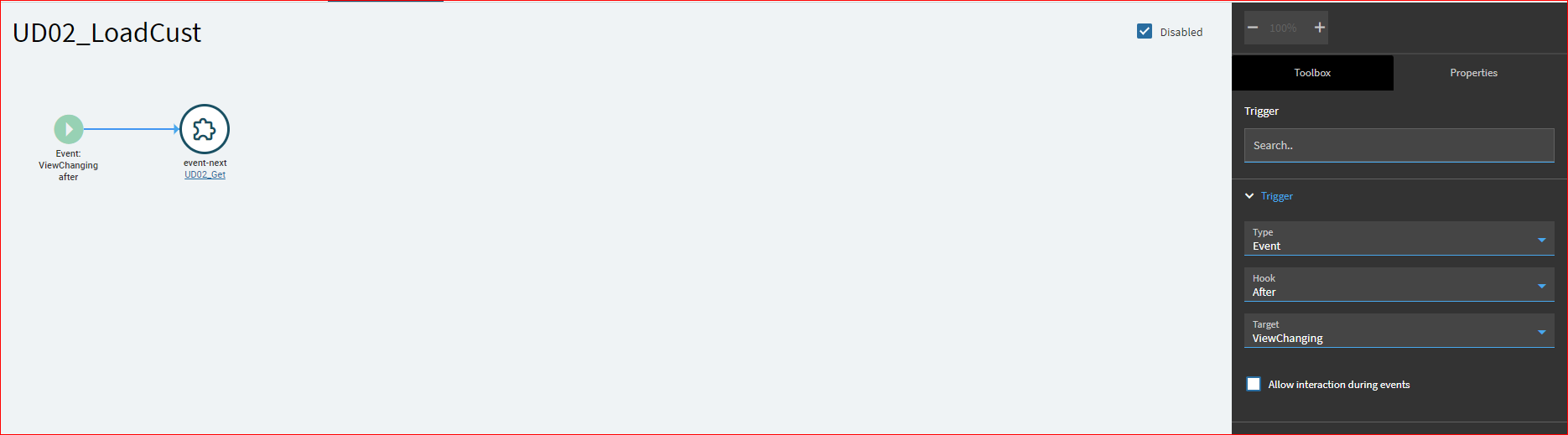

Unfortunately, since I think the BAQ loads before I can select a customer part numb, the filter seems to be applying before I load the customer part it is supposed to be using so the filter is empty. I tried to be clever and created a new event that runs the dataview event after the view change which the debug tells me is the last event that runs, but it doesnt seem to be working.
the filter does work when applying it to the grid directly, but im not sure what I am doing wrong still I feel like it should just work? Heres where the filters dont work
And I threw it on the dataview for good measure, but no cigar
You need to use this as your trigger to run the BAQ.
Set your Trigger to:
DataTable
Column Changed
CustXPrt
XPartNum
That should make your BAQ fire every time someone selects (changes the value of) CustXPrt.XPartNum

All I have to go on is the initial images of your dashboard… but, how does it work?
You have a Customer PartNum at the top… that is read only. How/where/when is that getting chosen/selected?
What is the grid showing? Is that the BAQ results (UD02 dataview)?
