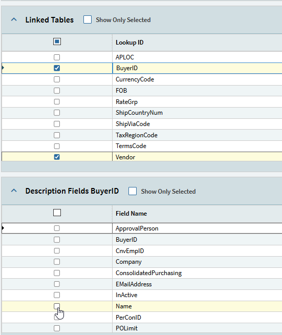

Looks like you already solved this but I would have done this through pick links. Then all you have to do is reference the additional field in the dataset after selecting it in the rdd.
