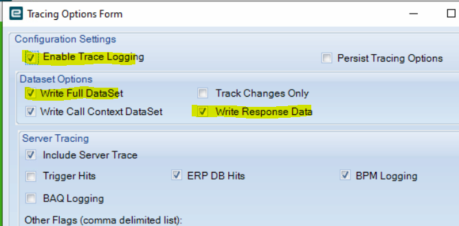

Assuming that if you add the part manually to a job it gets marked as direct then turn on tracing with the full dataset and response data, check trigger, bpm and db and add the part and look at all of the methods and see if you can find where the buy direct flag gets set.
Not sure I know how to do the tracing.
You need to download the ice tools guide from EpicWeb to get the details, but this is the general idea. Assuming you are using one of the Classic UIs turn on tracing
Set options and ok

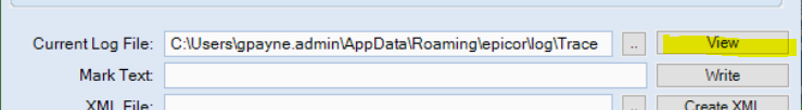

Do the processing in the sceen you want to trace.
Return to tracing options and click view.
Ahhhh yes ok, I have done that before. Thanks Greg!
