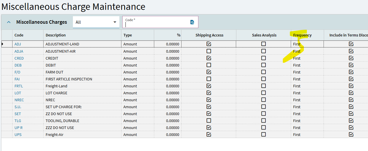

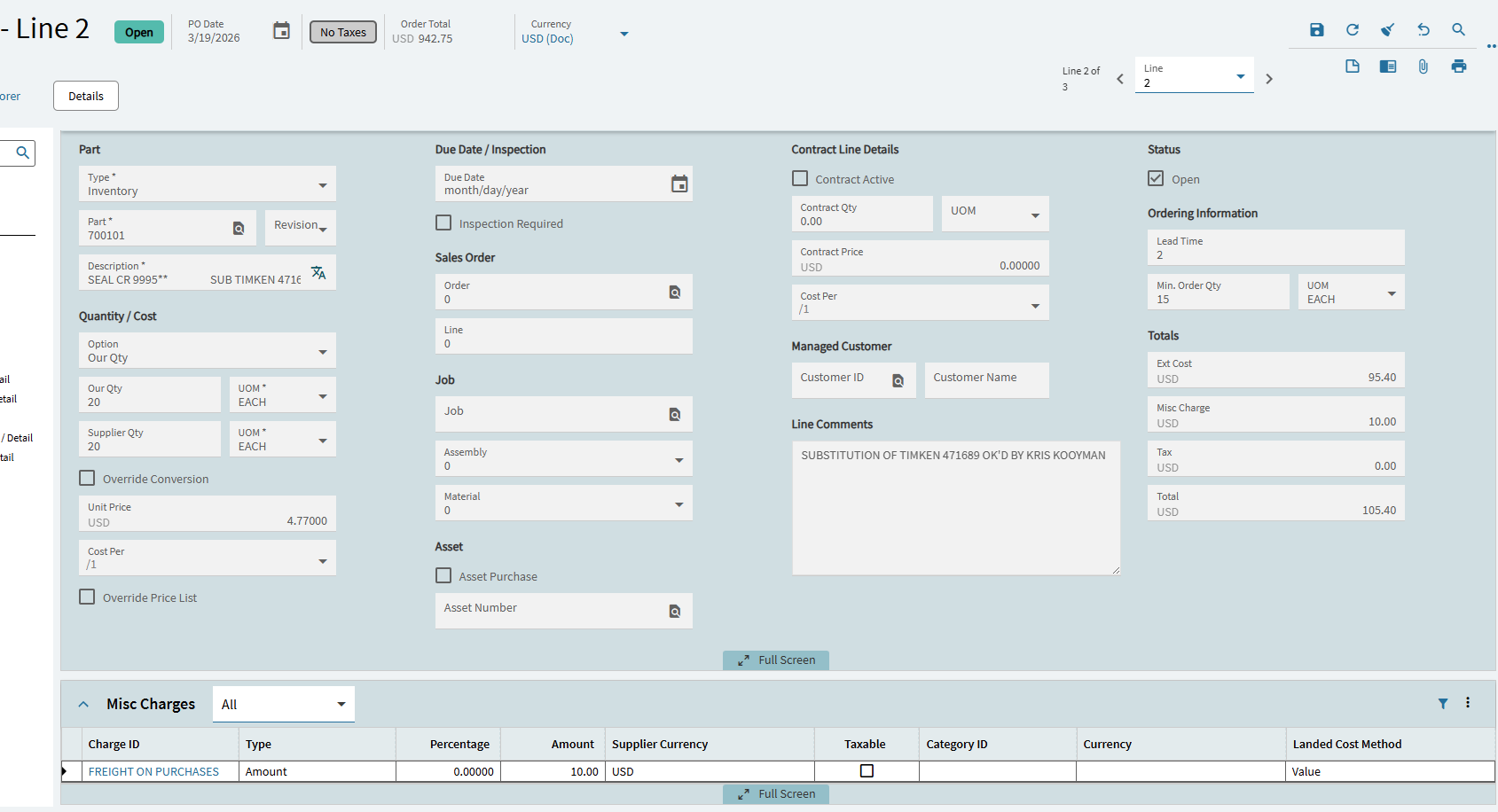

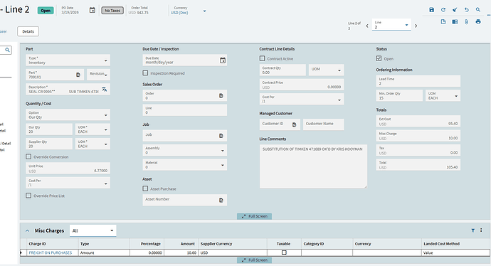

I suspect there is either something wrong with your report format (like it had been customized at some point), or your charges aren’t sitting at the line level correctly. Can you show the rest of the screen that shows where the line misc charges are?
Do you know if your report SSRS has ever been customized?
EDIT: Also make sure the misc charge type is not set at “Every”.

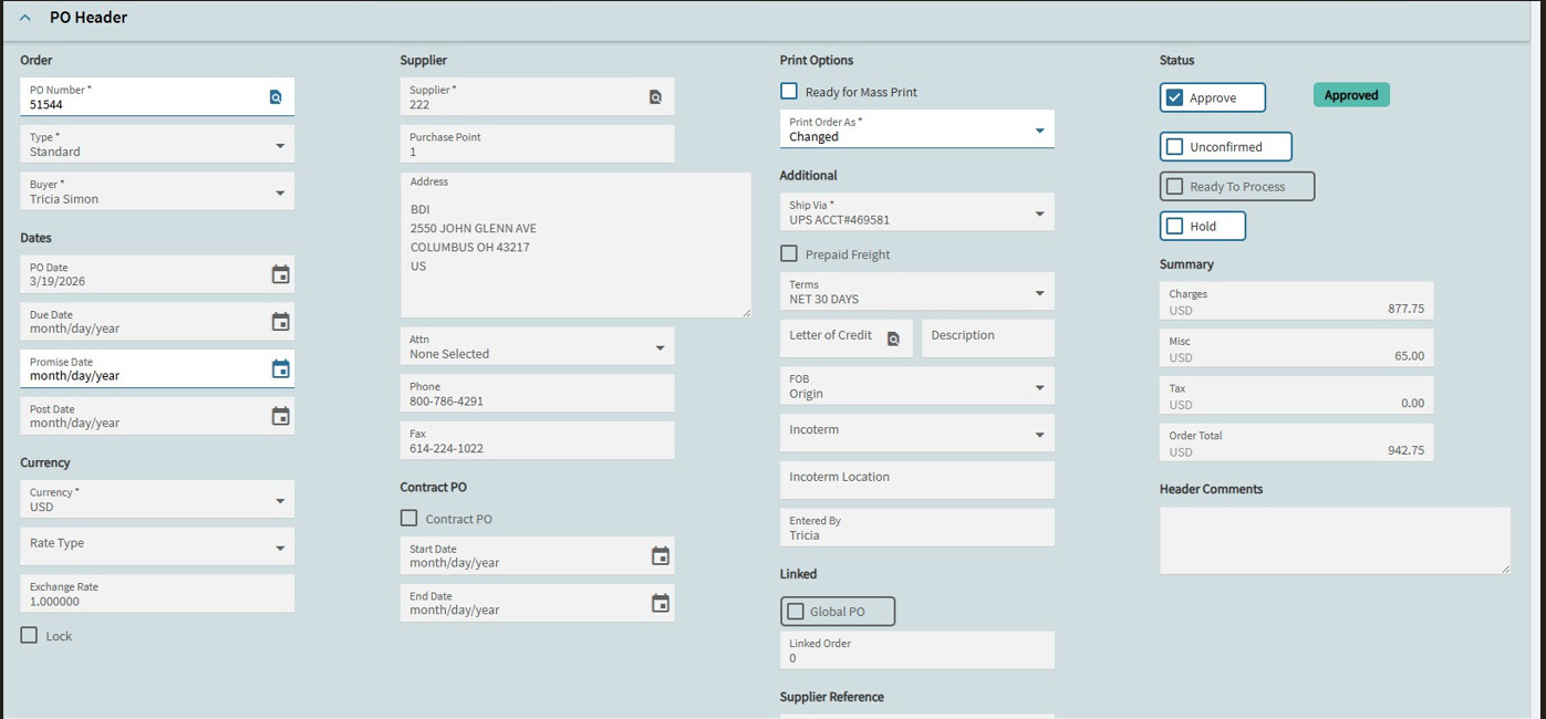

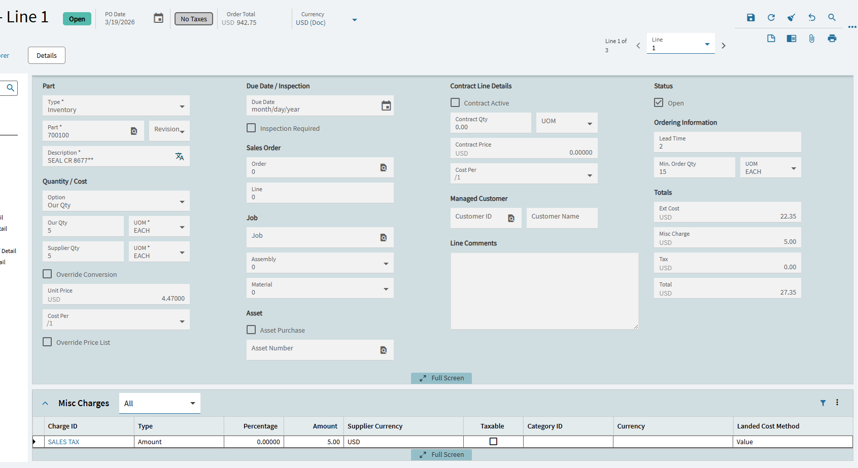

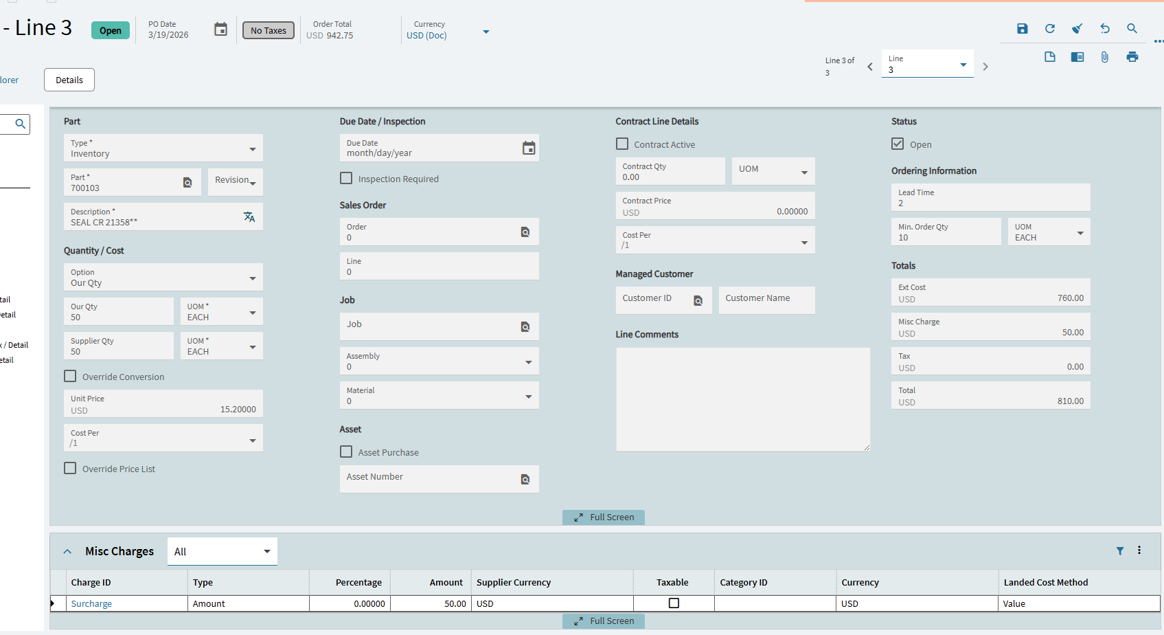

Nate - I’ll do screen shots of each line.
And yes - I believe it is a customized form.

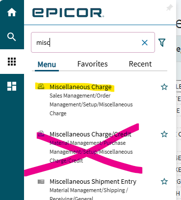

Go to Misc Charge Maint. and check the frequency of the charge type there.
It doesn’t show a frequency column. I checked Personalization - no option for that. ??
Damn Epicor and their dumb names… You’re almost there…

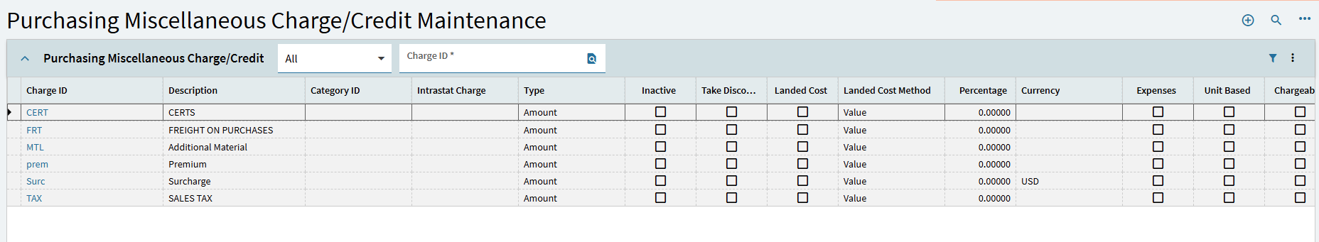

The Misc charges set up under Purchasing do not show on the “other” Misc Charge screen.

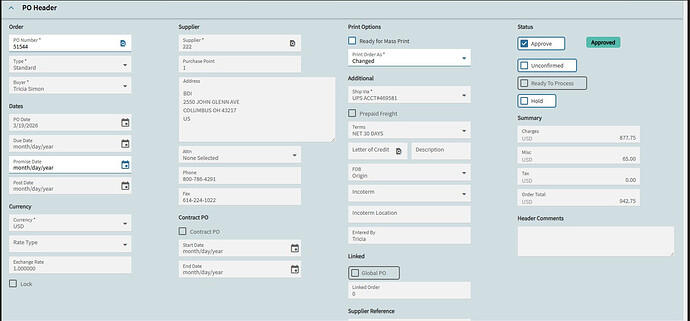

Nate - just an update. I tried printing the default PO form and it worked perfectly. I’ve turned the issue over to the gentleman who handled the customizations when we upgraded to the cloud - let him figure it out! LOL Thanks again. :slight_smile: Have a great weekend.
