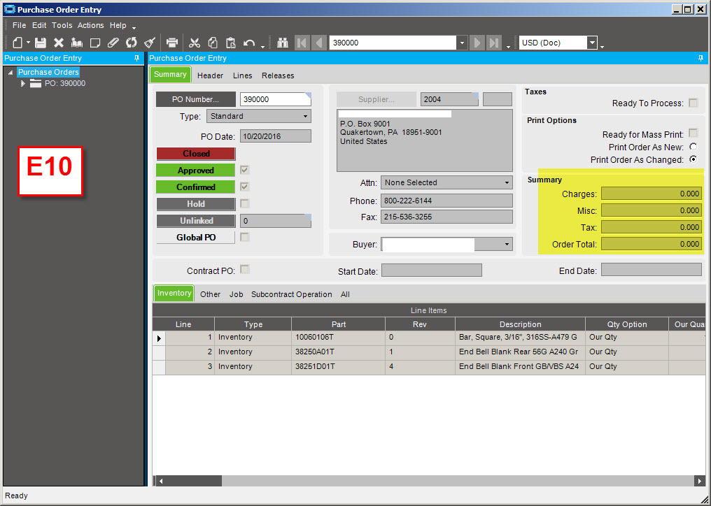

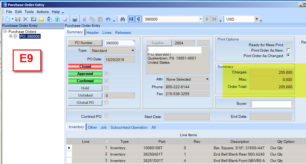

We’re testing E10 vs E9, hoping to go live this summer on E10.
Comparing the PO entry for same PO, our Summary area for charges fields is blank in E10.1.500.15.
See screenshots.
Does anyone else in E10 have error with Summary area of PO not showing charges properly?
