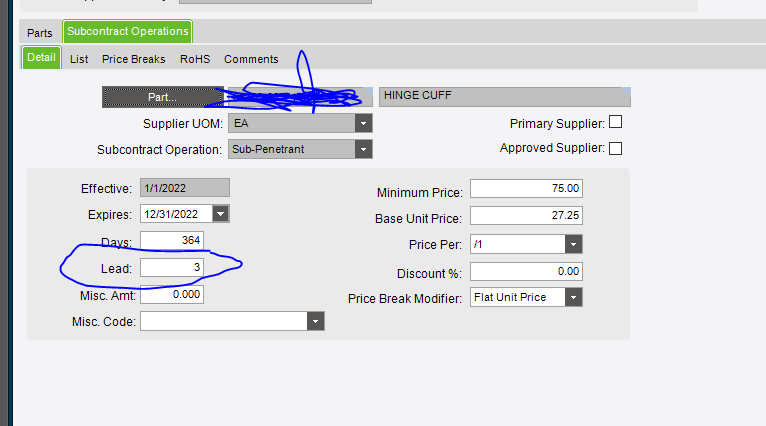

Which field on the Supplier Price List takes precedence? VendPart.LeadTime (Parts>Detail>Lead) or PartXRefVend.LeadTime (Parts>Supplier Parts>Supplier Lead Time)?
Thanks again!
I don’t know the actual field name, but I can point out it’s location.
Thank you! :slightly_smiling_face:
