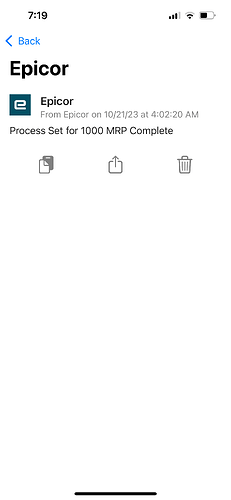

I wanted to share the code I use to get push notifications from Epicor. I use a service called PushOver. I write a Epicor function using the below code and place it at the end of a schedule or process set and this tells me when the process is complete. Thought it might help someone who does sys admin work on the weekends like myself.
