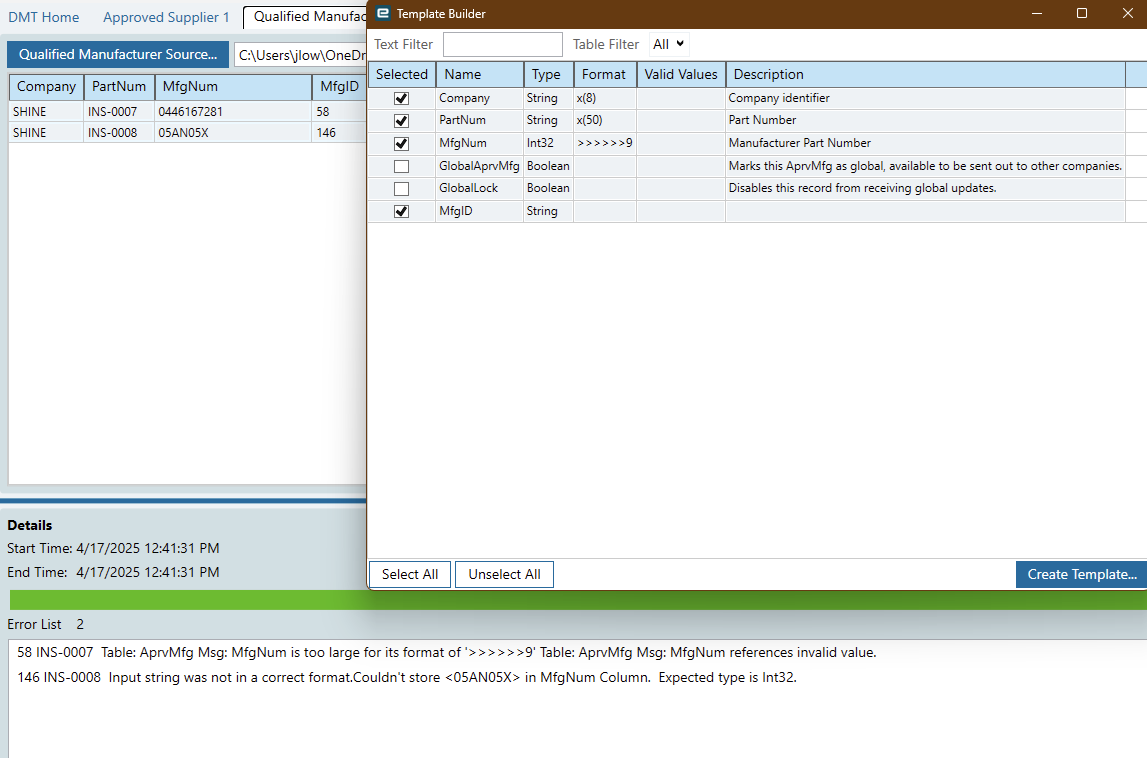

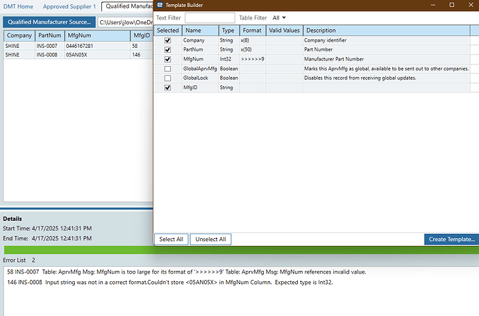

Does anyone know why I am getting these errors when trying to DMT MFG Part Numbers into Qualified MFG, but if I open that screen in Epicor it happily lets me type all that info in?

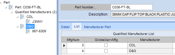

Looks like a case of a bad description in the template for that field. MfgNum is just a sequential integer assigned to the qualified manufacturers of the part.

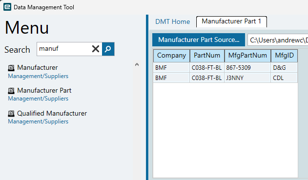

If you need to load a manufacturer part number, use the Manufacturer Part load instead of the Qualified Manufacturer load. The Qualified Manufacturer load would be used if you just want to assign the manufacturer to an internal part but not add a separate manufacturer part number xref.
