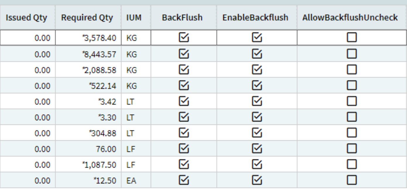

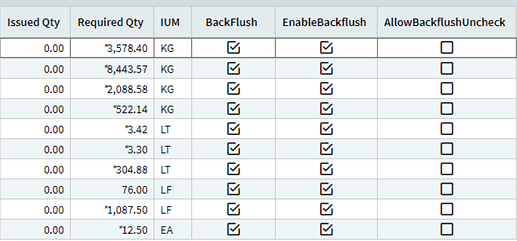

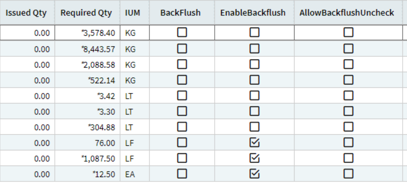

When i use our existing part details in a job where it’s “Time and Quantity”, we start by seeing that Backflush and EnableBackflush are checked off (not sure what the 3rd backflush one is for).

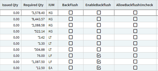

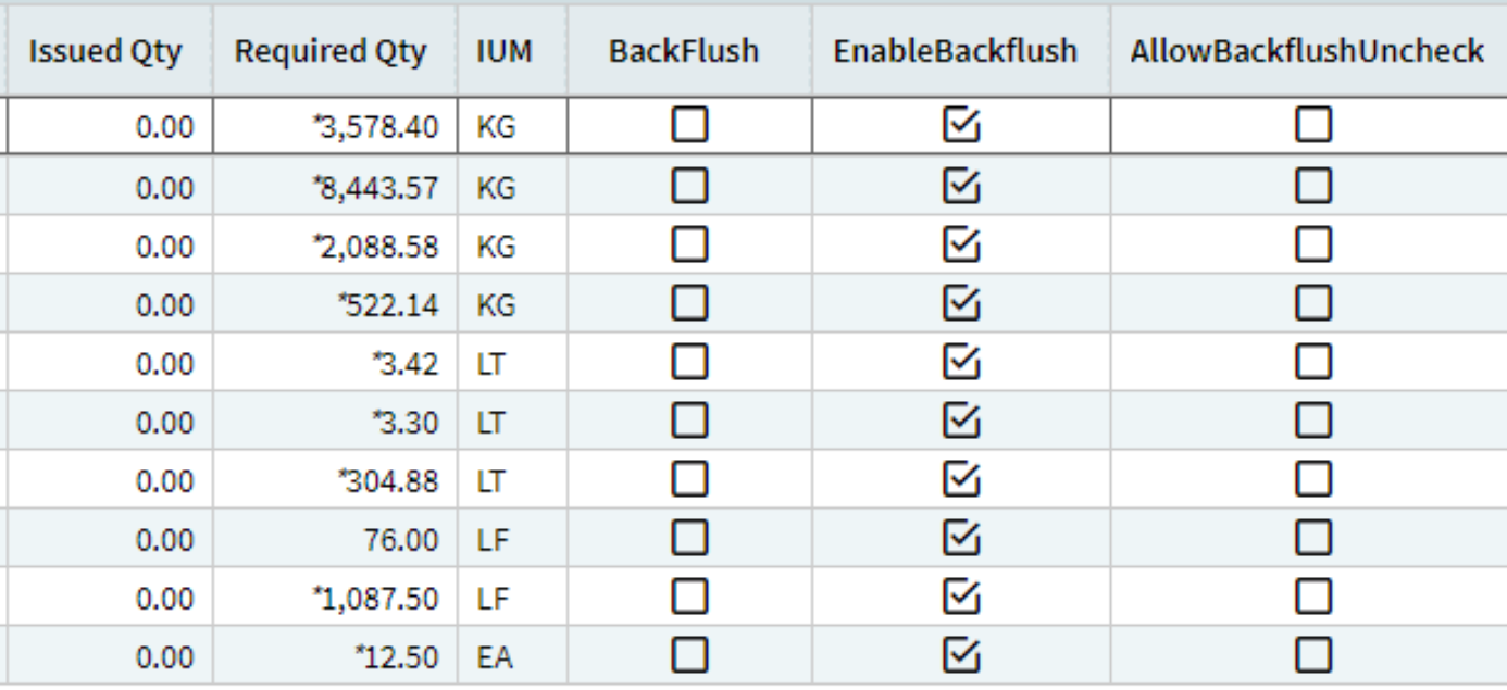

Then in the job i change Operation 10 to Quantity Only and it removes the Backflush checkbox but keeps the EnableBackflush checkbox. Note that i only changed Op 10 but it removed the Backflush from all materials even those tied to Op 20

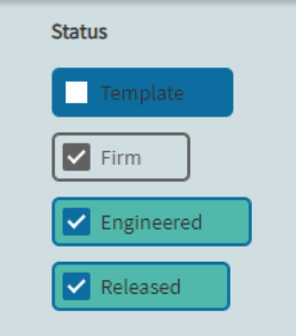

Once i check off “Engineered”, nothing changes, once i check off “Released” nothing changes. Backflush remains unchecked and EnableBackFlush remains checked
Once i “Start Activity” in the MES on Op 10 the “EnableBackFlush” now shows unchecked for materials assigning to Op 10, i have not yet ended Op 10 or reported Qty at this point.

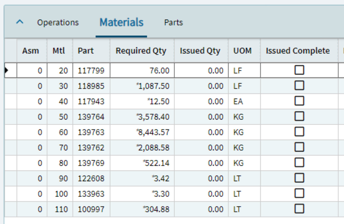

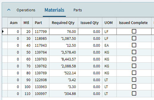

After Ending Op 10 and reporting qty, as soon as i clock into Op 20 the same thing happens to those materials. End Activity and report qty, open the job in Job Closing and nothing has been issued. Planning team must select “Backflush” from this screen in order to issue materials.
