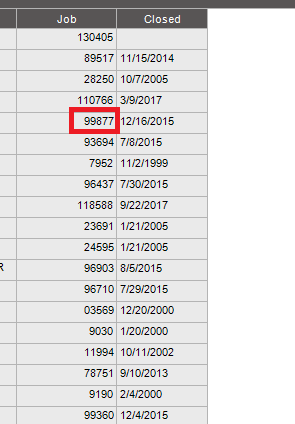

My problem lies in how Epicor is interpreting JobNum. Example: my query brings back this job num (99877) as max job num for this part:
1

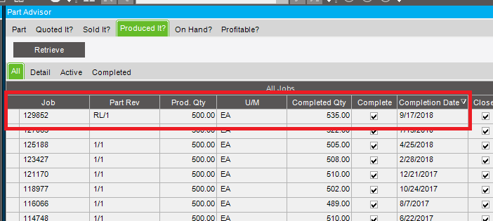

When I look at Part Advisor, I can clearly see that the newest JobNum is 129852:
What is causing Epicor to see this 5 digit job number (99877) as larger than the 6 digit job number? I tried to set datatype as 6 digit int but it hasn’t helped.

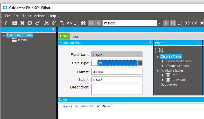

For good measure, here is my query:
2

I think the problem here is that the JobNum field itself is a string.
Strings are sorted like this:
1
11
111
2
22
222
Its sorts by ALPHA, JobNum is a string. If you can ensure you always will have a number, you can cast it to an integer in a calc field and work that way.
Instead of using MAX(jobnum), could you instead get the job from the max CreateDate? This should save also accomplish the purpose and won’t break if someone manually types in a jobnum string in job entry.
I have to agree - this is a much better solution. Kudos.
