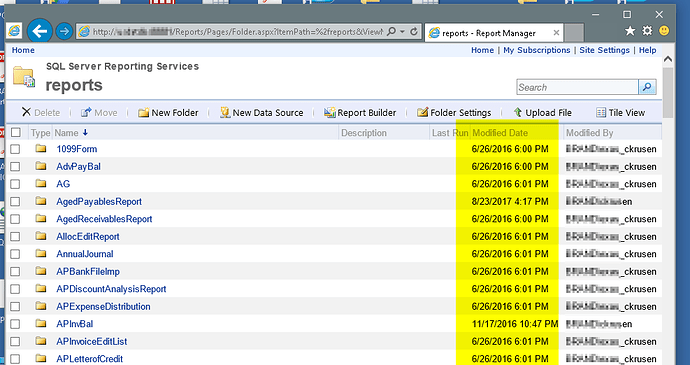

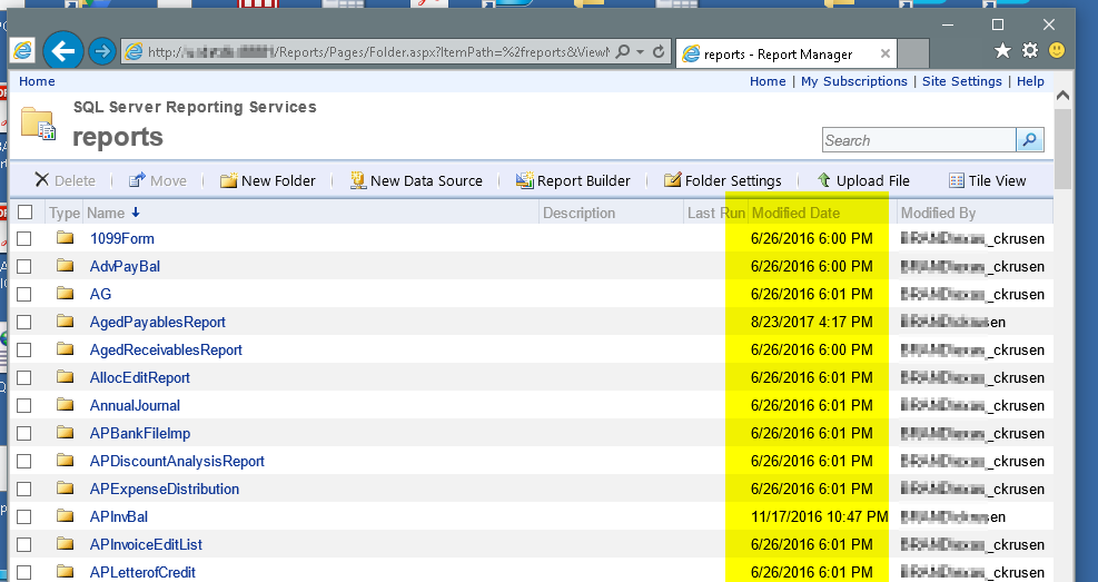

I’d like to query the RDL repository to get the Last modified date of each object (Reports and Folders) in our SSRS. I can see them when I use the report browser like:
But I’d have to manually enter each folder and sub folder, if using the browser.
