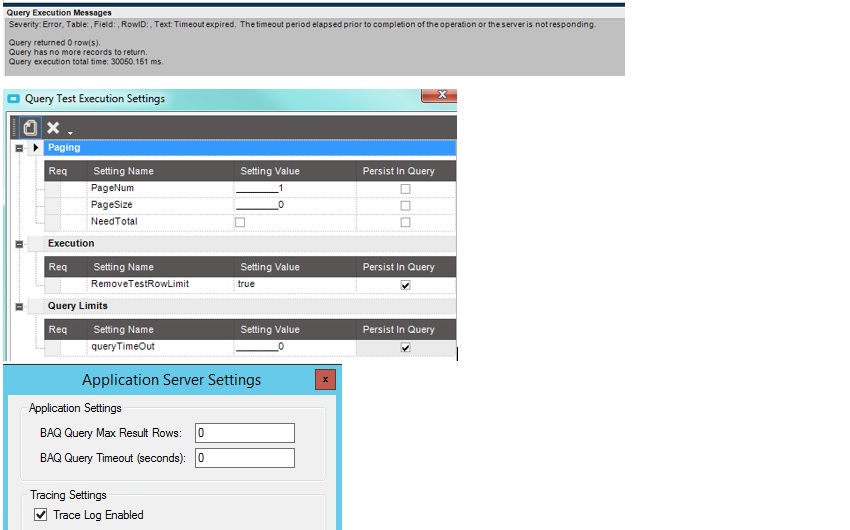

Anyone see a query timeout even though the settings are set to not be limited in the various spots?

It’s a baq that previously was working and grabs BOM information. I’m more confused why it’s still capping at 30 seconds even though its basically been told to be unlimited.

Have you tried to set the server to something other than 0? lets say 600.
just to see if the timeout setting is working. it looks like the 30 seconds limit was still in effect.
I only ask about the display query is then there are other areas that can be looked at as well.
When it worked, how long did it take? It seems odd that you would need a query that would take that long.
I know there is likely some issues with the query and will start to diagnose that. As mentioned, I was more surprised it wasn’t honoring the timeout values.
For what it’s worth, it seems the 0 timeout setting in the BAQ doesn’t seem to actually be unlimited. If I change the # to something else as Ken suggested (I chose 500) then it will hit that timer. On the flip side changing the server side limit to say 200, it didn’t stop at 200… I’m still confused on how the 2 limits work but obviously the BAQ needs to be re-worked.
