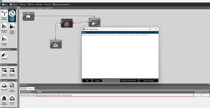

Might be easiest looking at the the GLBCustCredit table to do this.
  • An intrans
  • Condition if credit hold changes from any to true.
    *Grab the custnum, store in a bpm data field.
  • Call a standard BPM.
In the Standard
  • Condition "called by the in trans bpm
  • Do a DB loolkup in custom code something like
decimal CustNum;
CustNum = callContextBpmData.Number01;
    this.PublishInfoMessage($"{CustNum}", Ice.Common.BusinessObjectMessageType.Information, Ice.Bpm.InfoMessageDisplayMode.Individual, "Customer", "Update");
var CustCredit = Db.GlbCustCred.Where(x => x.CustNum == CustNum && x.Company == Session.CompanyID && x.ExtCompany == Session.CompanyID).Select(x => new{ x.ARTotal, x.SOTotal}).FirstOrDefault();
if (CustCredit != null)
    this.PublishInfoMessage($"ARTot: {CustCredit.ARTotal} SOTotal: {CustCredit.SOTotal}", Ice.Common.BusinessObjectMessageType.Information, Ice.Bpm.InfoMessageDisplayMode.Individual, "Customer", "Update");
else
    this.PublishInfoMessage($"Uh Oh GLBCustCredit Is Null!", Ice.Common.BusinessObjectMessageType.Information, Ice.Bpm.InfoMessageDisplayMode.Individual, "Customer", "Update");
Take the two values and use them in your email, and format as desired.

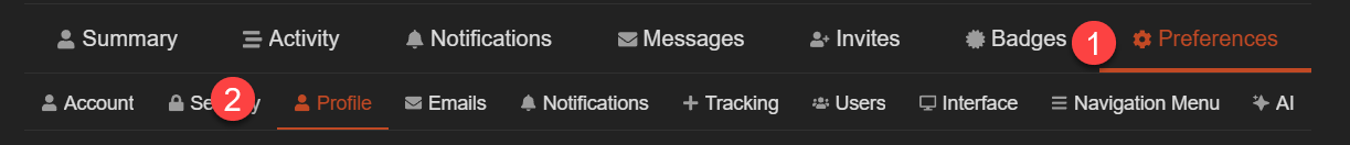

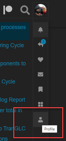

Thank you - I am on an updated version, unsure how to update that here.
Click your avatar at the top right
Then click the little person icon (see Below)
Then click Preferences then Profile and scroll down you will see the version option. You can update there.
