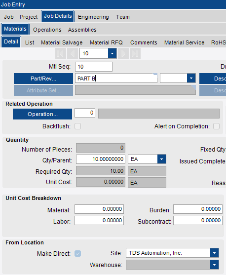

yes, if the sub-level parts are marked as non-stock, then the resulting sub-jobs become make direct jobs, and they reference their parent job.

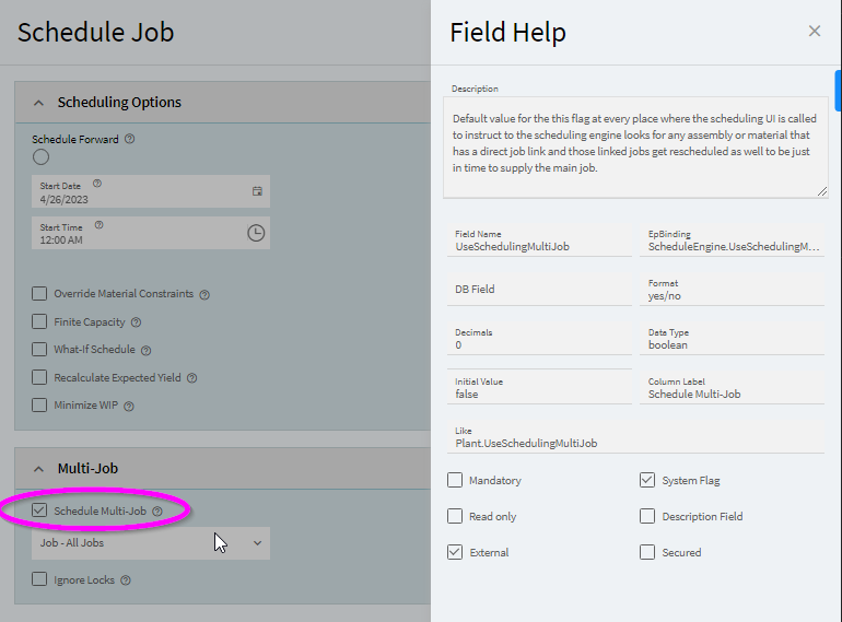

Also when scheduling ANY of the jobs (parent jobs or children jobs) you can have it move around the schedule of all associated jobs too… This is done with the “Multi-job” scheduling option:

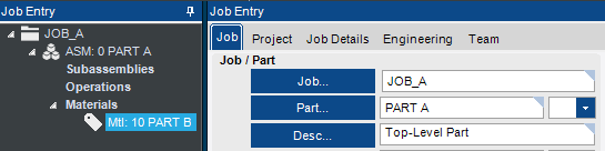

Your component parts on the top-level job would be materials, marked ‘Make Direct’.

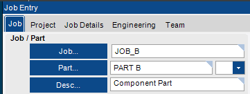

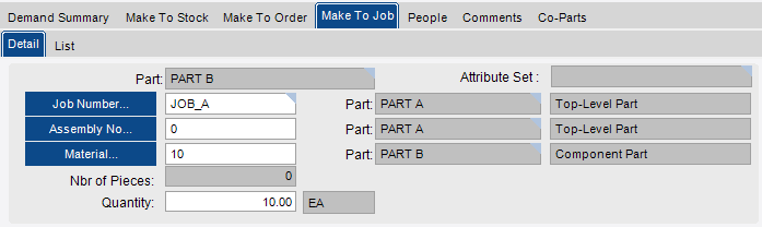

The ‘sub’ jobs to produce those component parts are linked to the parent job by a ‘Make to Job’ link.
