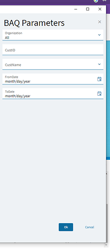

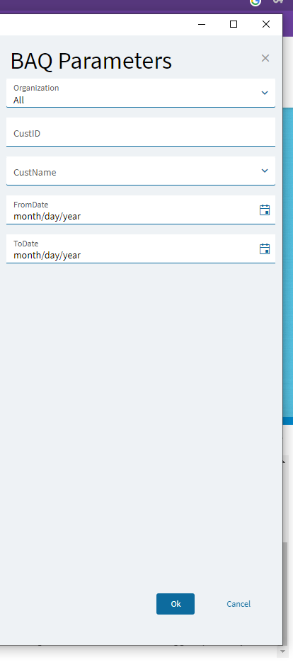

When I try to run the panel card grid (Tied to a BAQ DataView), it asks me for the parameters for the BAQ.

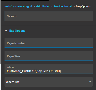

Which seems normal, But Is there any way to turn that option off? I already have the parameter coded into the panel-card-grid to run for the current CustID
Just wondering if anybody knows how to turn this setting off. I can’t seem to find a toggle option anywhere
No, that is a filter you have coded there.
I’m not sure there is a built in way to do what you want without removing the parameters from
the baq.
Hmm. Instead of getting rid of them, is there a way to set a default for them? Or change the properties of them in any way?
