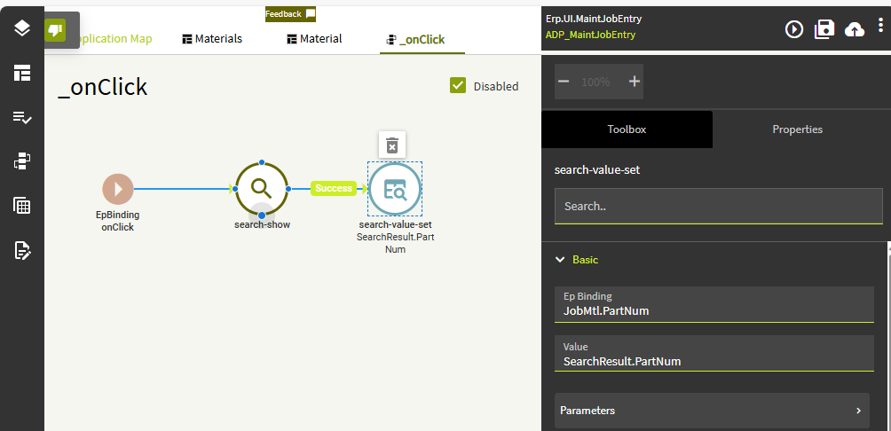

We’ve recently upgraded to version 2021.5 on SaaS Cloud and have encountered an issue with Quick Searches. Specifically, the selected value is not being assigned to the mapped EpiBinding. However, when using a Basic Search, everything works as expected.
I’ve also tried creating a new Quick Search, but the issue persists.

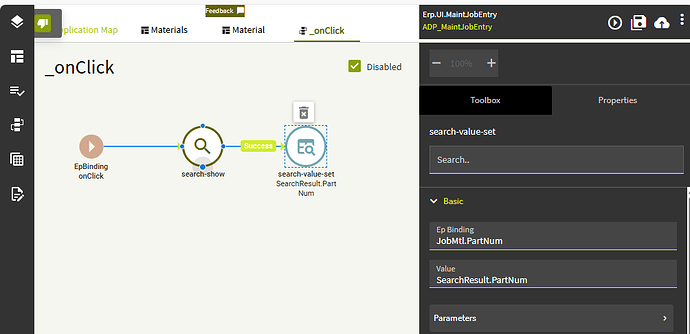

In Search Show Properties , kindly tick the “Use get Rows” checkbox and save the layer and try and let me know..
This appears to work for a search selected from a button for example.
Oddly if you access the same search from the context menu it also works on a screen unrelated to the change made!!
Doing some more testing and getting feedback from users.
