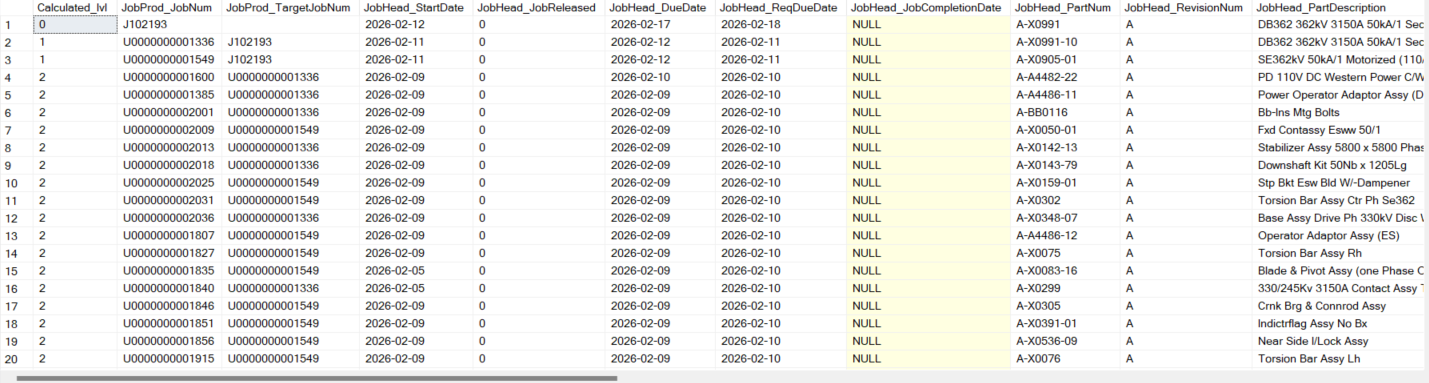

We are working on a model which creates a make direct order and all the relevant materials that go into the job that fulfills the order are also non stock. Our BoMs are 6 levels deep so naturally making everything non-stock in the assembly area makes it all linked to each other. We want to do it this way so that we can find what sales order any job is allocated to.
I now want to create an updatable BAQ OR a quick search that is going to help us in firming the entire job tree once we have ensured that the materials and load vs capacity is ok.

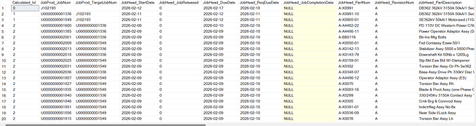

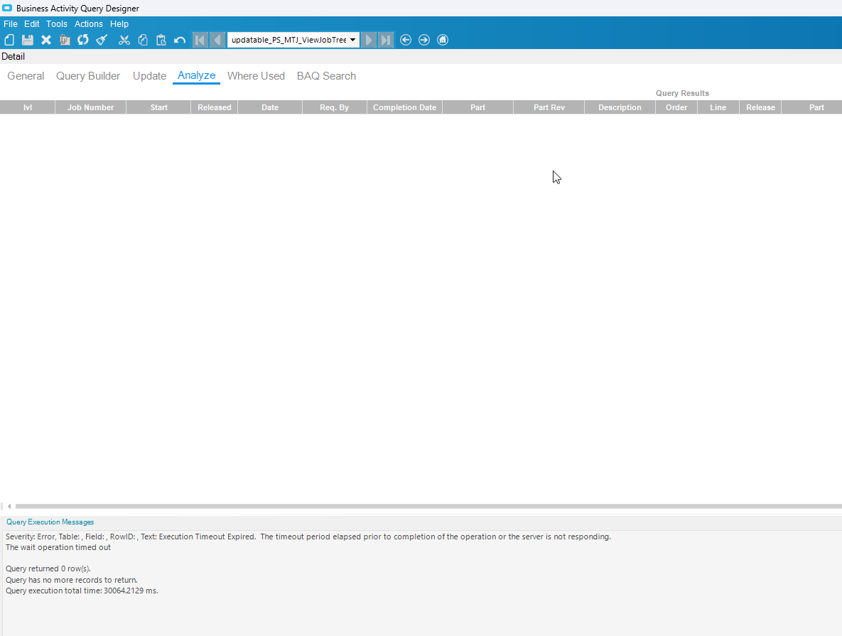

I tried creating an updatable BAQ, which works fine when I run it in SSMS but times out when I’m running it in the BAQ as a test.
I also tried creating a quick search on job status maintenance so that I can pull all the jobs related to a sales order and firm them in one go through the job status maintenance, but the quick search requires a filter on the anchor to find the sales order that the job is linked to (which is the level 0 job) and then find all the relevant job links via recursion.
However, the quick search can only prompt to filter based on the entire query and not pass the parameter inside the anchor (before the union all section of the script), which then returns just one row which has sales order populated instead of the entire job tree.
Any ideas?
Expected output
Current Output (with BAQ)
Current Output (With QS)
