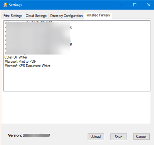

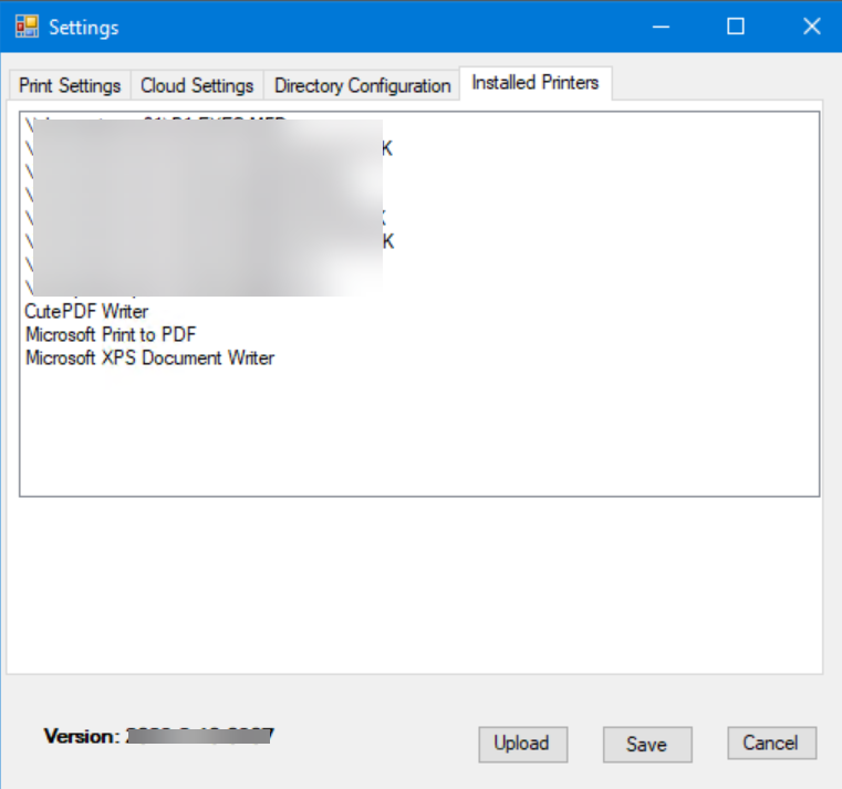

Check your local QS server make sure the client is running and that it can “see” your printers. Also check the Cloud settings tab to ensure you’ve got that all setup correctly.

yes the quick ship print monitor service is running and can see my printer. I have never seen this Cloud Setting before. Where is this and how to do you get to that? the screen shot you provided I have never seen before.
I never heard of an Quick Ship Cloud Printing Edge service before. We have the Quick Ship print monitor service installed and running.
Sounds like the client wasn’t installed correctly on your QS print server. As @bderuvo mentioned Support will help you get it setup and configured.

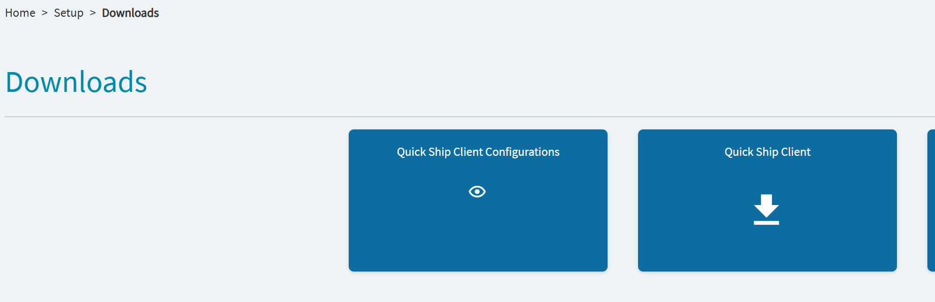

The client configurations are in Quick Ship > Setup > Downloads
Epicor did all the installations. UGH!!!
oh that is for the viewer correct?
