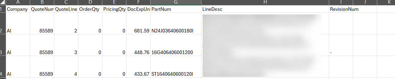

I am working on a DMT to add Quote Detail lines. I have part descriptions added to all lines in the LineDec field. For whatever reason when I run the DMT some of the lines fails with: QuoteNum:855589, QuoteLine: 4 Table:QuoteDtl: Msg: Description is required.

Can you provide an example of one that fails including your DMT template headers?

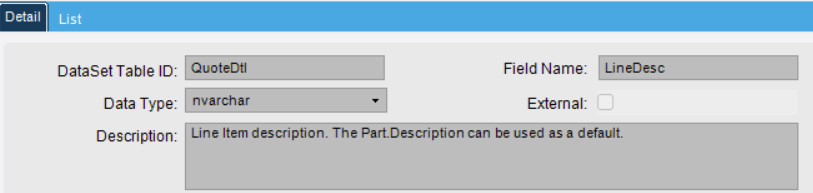

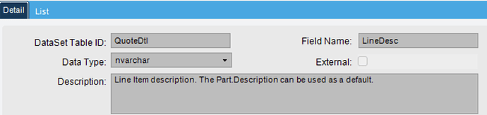

According to the DMT template if a part is not in the part master you need to add the LineDesc column. All my parts have descriptions.
The error is probably misleading as you are including the LineDesc column. There is a CheckPartDescription column too that for those lines perhaps set to FALSE. Maybe even the KitFlagDescription set to P (Parent part)

What happens if you strip the file back to just Company / QuoteNum / QuoteLine / PartNum / LineDesc and upload?

Here is the DMT template I used when importing legacy historical records.
I uploaded 19400+ quote detail lines with no errors, so this worked for me. It may come down to column order.
Agree with the column order shout
