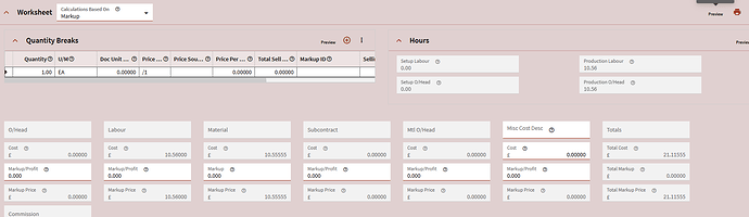

Hopefully this is a simple fix but one of our quoters has just pointed out that the worksheet in Quote enginnering is showing the labour cost to 2 DP where the Production Standard is showing 4. This is then having a knock on to the total costs.
Anyone got any ideas? (Labour rate on that operation is £1)

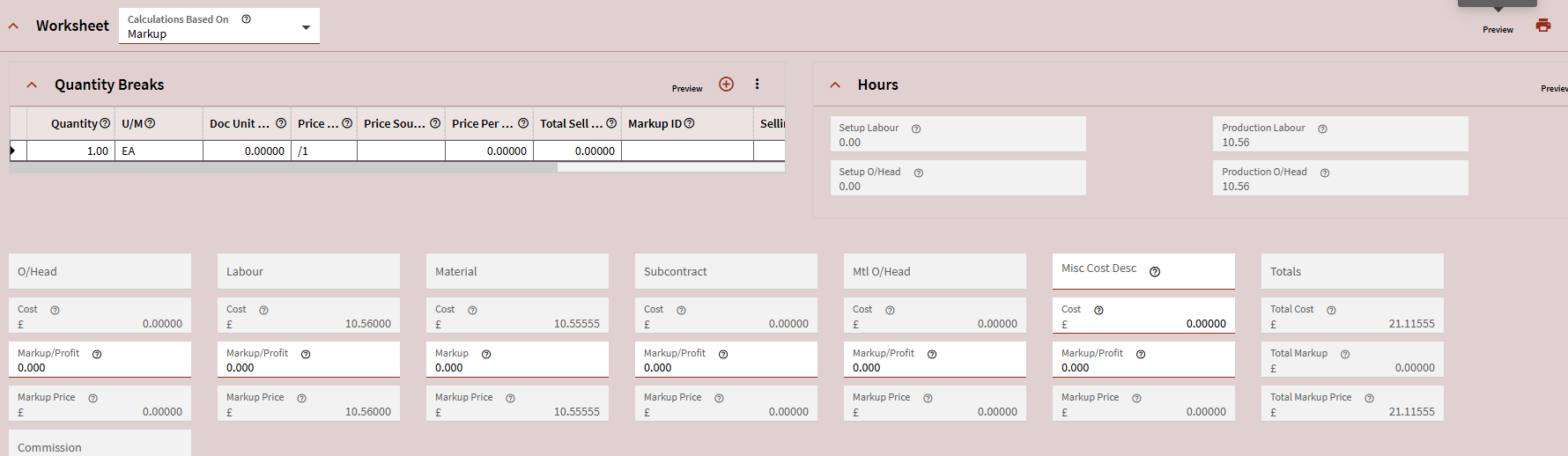

It looks as though the system is round to 2 DP. I did a test in my Pilot below for both Labour and Materials at 10.55555 and Labour went onto the worksheet as 10.56 and materials 10.555.
I guess the question is, should it round to 2 DP? :thinking: :person_shrugging:

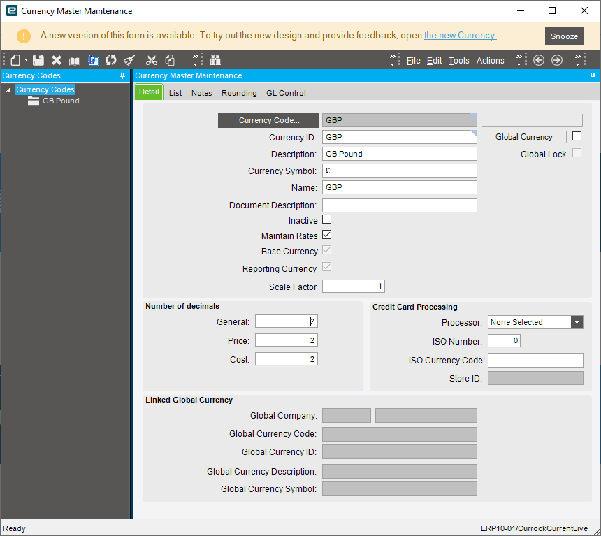

Have you checked the setup of the currency record as you can define the number of decimal places in the number of decimals area:
Hi Sue,
Yes and it is setup correctly.
Daniel

If i flip the labour rate for the Op and the Production Standard so Labour is 15.55555 and PS is 1 the worksheet displays to 5DP! :thinking:
