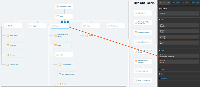

Hi Tory, my best guess is you got hit with a known issue/glitch where page bindings mysteriously disappear.
On your Application Map… click on various pages and look for missing Ep Bindings:
If I delete one:
… And then preview:
Boom… no attachments (and also no “New” icon, either). Which makes sense. How can the system attach anything on that page, if that page doesn’t have a binding. In this case, it doesn’t know the attachments should be attached to QuoteHed.QuoteNum. Or if you clicked the “new” button, it doesn’t know you want a new QuoteHed record.
If I add it back in:
… and then preview:
A couple icons come back… back in business!
