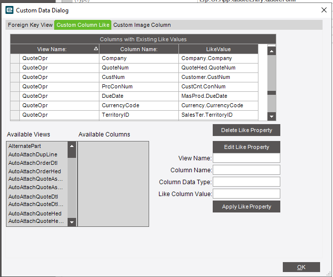

Still stuck on this classic Ux customization.
An AI helper is suggesting that I modify extended properties so that QuoteDtl.QuoteNum and QuoteLine are “like” the corresponding QuoteOpr fields. I’m really unclear on how this should look as well, if it’s even the right path.
I thought maybe I was on the right track here, but QuoteOpr.QuoteLine is not available to customize. Is there somewhere I can change that globally??
