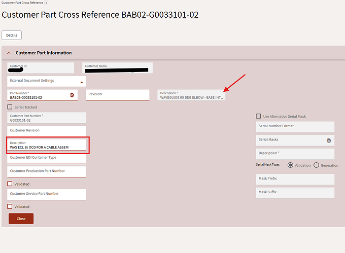

We have had a ticket raised by our quote team that on a recent quote that they raised the description that was pulling through was not correct. I have had a quick look into it and on one of the parts it is pulling the Description from the Customer Part Cross Reference Table (See below). Is there a setting somewhere that needs changing so it pullthe the description from the Part Master?
I think you have to go into the Customer Cross reference (Customer Part Entry) and set it to be the “secondary” reference… or “Not Printed”
You may have to play with it to get the setting you want. But I think this is what drives what part description is pulled into the Quote. You basically need to tell the system… Yes, I have a customer part number and a customer part description… but this description is Secondary… or “not printed” means don’t display this description at all… and it will default back to the master description.
Thanks David will give it a look
Looks like you do it at the customer level although i cannot see a DB Field that it is tied to to mass update our customers.
Query against Customer.CustPartOpts That may be the customer default setting.

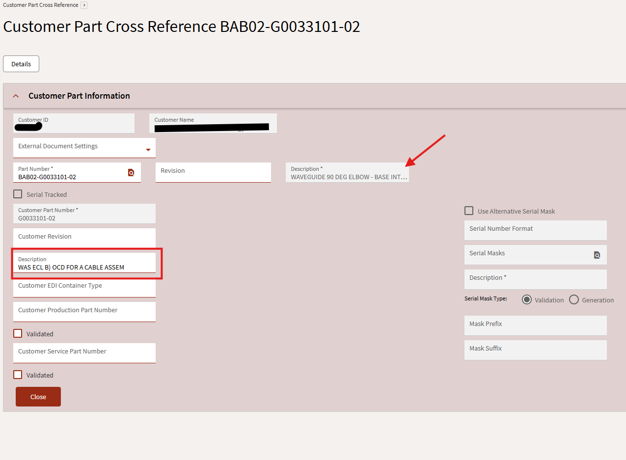

Interestingly… playing around in Customer XRef Entry… there is a combo box on the Customer level… AND one in the part num detail level. Changing one appears to change the value of both. They both impact Customer.CustPartOpts. So… I’m not sure you can truly control this on a part-by-part basis. It is only appears to impact it on the customer level.
I was able to copy the combo box settings from CustXRef entry into Customer.
Then set up the same rest-call it uses. Seems to work in both places now… and Customer.CustPartOpts SHOULD be DMT able, if you wanted to set it there en mass.

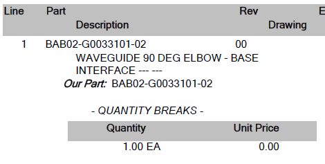

Interestingly i printed the quote form as Not Printed and Secodary and the OOB form as N shows
And as S
Even more confused now as i have just looked at the Quote form and this is the calculation for the CUstomer Part NUmber
=iif(isnothing(Fields!Calc_CustPartOpts.Value) or Fields!Calc_CustPartOpts.Value ="N" or
Fields!Calc_CustPartOpts.Value = "S" or IsNothing(Fields!XPartNum.Value) or
Len(Fields!XPartNum.Value)=0,Fields!PartNum.Value,Fields!XPartNum.Value)
Which to me looks like if it is N or S it is just showing our Part Number

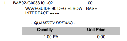

Okay, that must be how I got around it… customizing our quote form.
Stock QuotForm:
My customized QuotForm:
So… I’m ALWAYS showing our internal partnum as the primary reference on the RDL. I then do allow for the Calc_LineDesc… which is controlled by the CustPartOpts setting.
I then made the CustPartNum visible or not depending on whether there is a value:
Field expression:
="Customer P/N: " + Switch(Isnothing(Fields!Calc_CustPartOpts.Value), Nothing, Fields!Calc_CustPartOpts.Value = "O" Or Fields!Calc_CustPartOpts.Value = "N", Nothing, Fields!Calc_CustPartOpts.Value = "N", Fields!XPartNum.Value, Not IsnOthing(Fields!XPartNum.Value) And Fields!XPartNum.Value <> "", Fields!XPartNum.Value)
And if there was no customer cross referenced part, I hid the field all together:
This makes sense.
If opts is set to “N”… don’t print the custXRef partnum at all.
If opts is set to “S”… don’t print the custXRef partnum HERE.
Instead… it gets displayed here (as a secondary reference):
