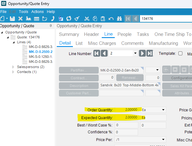

Unfortunately fields SellingExpectedQty and ExpUnitPrice are not populated fields in our environment. The Qty and Price are within the QuoteQty table.
Without SellingExpectedQty, how would you know which Quantity Break to reference? It’s one thing if you only ever have a single one, but if there are multiples, you need some way to choose which one you want.

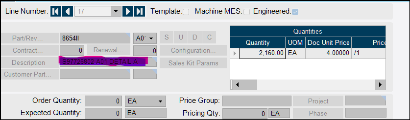

You are saying both of these fields are 0 or blank??
Correct…this is what I see:
Well, if there is more than one row in that quantities box, you will get multiple rows in you BAQ as well. Isn’t any way around that unless you know which qty break you want to select or if you want to arbitrarily pick one (like the first or last).
If you are getting more than one in the BAQ even though there is only one qty break entered, I would think you have something wrong with your join, like perhaps only joining on quote number and not quote line as well.

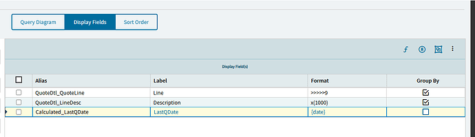

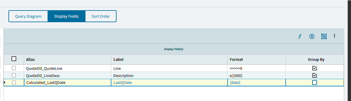

Sorry, I’m on a newer version of Epicor so I can’t send the BAQ. Create a BAQ with QuoteDtl & QuoteHed, the join will be automatic. Your Display Fields will be as below with the Calculated field as shown in my code which is equivalent to what you had.
