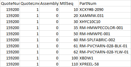

# QuoteMtl MtlSeq changes when importing via DMT **Category:** [Epicor ERP 10](https://www.epiusers.help/c/e10/5) **Created:** 2016-10-20 16:00 UTC **Views:** 2624 **Replies:** 23 **URL:** https://www.epiusers.help/t/quotemtl-mtlseq-changes-when-importing-via-dmt/35900 --- ## Post #1 by @ckrusen I understand that DMT uses the business object to create new records and that end up overriding imported data. There's a work around for this, for things like QuoteDtl.QuoteLine - as they are always incremented by 1. DMT aut assigns QuoteMtl.MtlSeq, but with a step of 10. This prevents "fixing" data if you have a MtlSeq that is not a multiple of 10. V8!QuoteMtl.MtlSeq = 35 become 40 in E10. And if the next record from V8 happened to be 40, then that overwrites original 35. What to do? Or am I worrying about nothing and should just let the new numbers fall where they may? Calvin --- ## Post #2 by @josecgomez MTL Sequence can be set in DMT so I am not sure what you are refering to here... If you set the MTL Sequence to number X it should honor it. --- ## Post #3 by @ckrusen Here's what was in the input file And here's what ends up in E10 DB MtlSeq 35 becomes 40, 61 -> 70, 62 -> 80, 100-> 90 --- ## Post #4 by @josecgomez That's strange.... Try and run the same file again (now as an update) --- ## Post #5 by @ckrusen Remove the records from E10 first? --- ## Post #6 by @josecgomez No, run the initial file again (now that the records are there) and run it as an Update. --- ## Post #7 by @ckrusen Okay. Here's what i've done 1. Removed all ecords for the QuoteNum\QuoteLine\Assy in question. Confirmed that E10 has no records for 159200\1\0 2. Processed the following - with both Add and Update checked 3. Qry'd E10 for 159200\1\0. I get 4. With the same data in DMT, ran the process with just UPDATE checked. Got 4 errors 5. Qry'd E10 for 159200\1\0. I get (note that there's an extra line now. **EDIT: No extra line, but 100 was redifined** --- ## Post #8 by @josecgomez Hmmm that seems like a bug then it should allow for changing the MTL Sequence... Epicor does... (you are on 8.03 though so maybe not)... maybe @Edge has some input on this? --- ## Post #9 by @ckrusen The source data is from 8.03. The DMT program is "DMT 4.0.12.4 for 10.1.400" --- ## Post #10 by @josecgomez How about doing the initial import again as Add Only so that SEQ 35 becomes SEQ 40 and SEQ 40 (should become 50)? --- ## Post #11 by @ckrusen 6. Ran "Add" with data from step 2 (above). Got 7 errors 7. qry'd E10 and got 3 more lines (35 -> 110, 61->120, 62 -> 130) --- ## Post #12 by @josecgomez Yeah but you need to "Clean' the system first so that no data exits. Then Import with Add Only I think then it should make 35-> 40 and 40 -> 50 etc.. --- ## Post #13 by @ckrusen 1. Deleted all related records - confirmed by querying E10 2. Processed original data with just "Add" checked. No errors 3. Qry of E10 yields same problem (MtlSeq replaced --- ## Post #14 by @josecgomez Hmmm Add only shouldn't be replacing.... that smells like a bug. Poke at Support? --- ## Post #15 by @ckrusen Email address for DMT support? --- ## Post #16 by @josecgomez DMT == Epicor just called the main number --- ## Post #17 by @ckrusen Last time I called Epicor about a DMT question, I was directed to DotNet.uk (or something like that) --- ## Post #18 by @josecgomez Right but epicor bought DMT and DotNet IT and they are now a part of Epicor (main) --- ## Post #19 by @ckrusen Hmmmm .... Are you sure that you can change the MtlSeq in a Quote? Using Actions \ Quote Line \ Mfg Details \ Add Material auto sets the MtlSeq. to 10 above the last item. I even tried using Paste update into the grid view, with: But the MtlSeq ends up being changed to a multiple of 10. --- ## Post #20 by @josecgomez You can in 10 You have to add the material, then Update the Number --- ## Post #21 by @ckrusen I tried that earlier. I did: 1. Add Material (the Mtl Seq is automatically set to then ext multiple of 10 above the highest) 2. Changed the MtlSeq number (was 110 to 61) 3. Entered the Materials P/N and Qty 4. Saved Upon saving the MtlSeq reverts back to 110. --- ## Post #22 by @josecgomez Something is up with your setup then... I can change the MTL Sequence all day long see below Original Change it, Hit Save Refresh Version 10.1.400.18 --- ## Post #23 by @ckrusen That is **JobEntry**. I'm taking about during **Quote Entry** --- ## Post #24 by @josecgomez Well hot damn we both need to pay better attention haha So yeah Ignore the last like 10 replies.... It doesn't allow gaps between those records sorry... **I'll go sit in the corner now** --- **Canonical:** https://www.epiusers.help/t/quotemtl-mtlseq-changes-when-importing-via-dmt/35900 **Original content:** https://www.epiusers.help/t/quotemtl-mtlseq-changes-when-importing-via-dmt/35900
