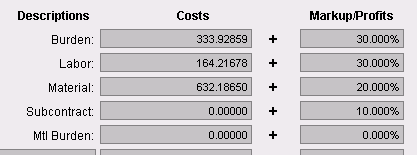

Here’s the Worksheets page for my quote line:
The query against QuoteQty for that quote/line shows:
Note: the Burden, Labor, Subcontract and Mtl Burden all match. The Material is showing 20% on the screen, 10% on the table.
