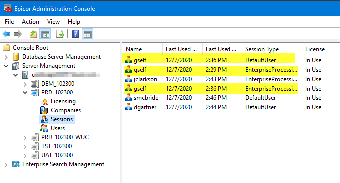

In the Epicor Admin Console, select the App, and then Sessions.
Here’s a screen shot from EAC
user gself has three entries, but is probably only logged in once (maybe twice).

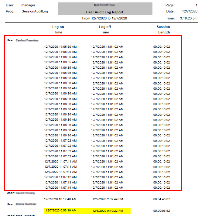

Not nearly as useful, but you can run the “User session Log Report” (System Setup -> Security Maint.)
Note that it can show multiple entries per person, but that doesn’t mean that they had simultaneous sessions.

User Session Log Report can go back in time (you enter a date range). But as I said, that report is almost useless. When I run it with just todays dates, one user appears to have had many sessions, but its really just one.
Note that the “Logoff Time” is often before the “Logon Time”

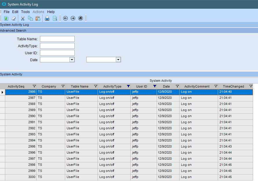

I did get a little further I learned about the System Activity Tracker and now after enabling the Activity Log in Company Maintenance I’m seeing something strange that could be related to the problem I’m trying to solve(out of default licenses). We have a user webservices we use when we need to consume a REST API and I’m seeing this user login every couple of seconds, which appears to be a problem. Where can I look to see what this user is doing? In E9 there was a plain text log file I could look in, but in E10 I’m not sure where this is logged?

Although in looking more at the output from System Activity Log Tracker it indicates we had a person login 15 times with in 5 seconds, that makes me not trust the data I’m looking at and/or question how I’m interpreting this data(maybe it doesn’t mean what I think?)… So unfortunately I’m back to my original problem of not knowing how to determine how many users are logged in previously(when an error occurred saying we were out of licenses). Any pointers would be appreciated.
SysActivityLog

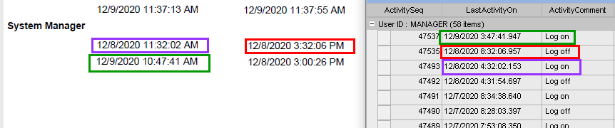

And the oddity between the SysActivityLog table and the User Session report, is that there is an exact 5 hour difference - Which I belive is the difference between EST and GMT.
Well you found that table while I was composing my response.
One thing that stands out, is that there aren’t an “Log Off” entries in the Activity Comment

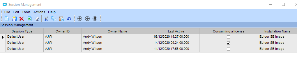

10.2.600 gives you an admin screen in the client to show who is logged in, sessions can be deleted.
