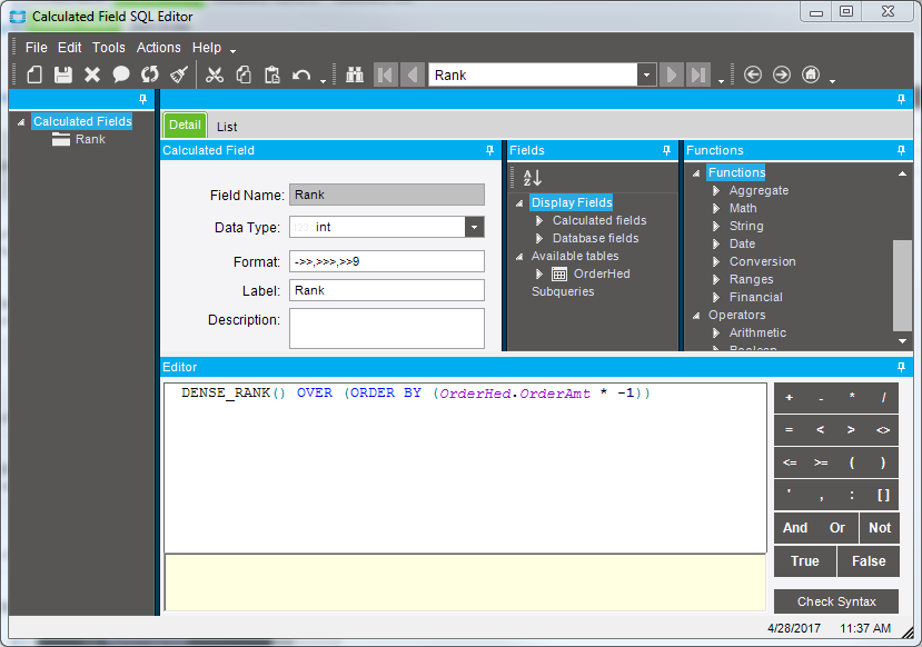

Looks like I was able to come up with the right syntax and solve this issue with more detailed Internet searching. Just adding my outcome into this thread so that others may benefit from my positive outcome.
Key elements for a column of rankings relative to a BAQ query are:
  • Create a Calculated field that is of integer type
  • DENSE_RANK is the proper function to use
  • Call out the Table.Field that you want to order within the ORDER BY ()
  • I needed to invert the results to return the highest value as Rank=1 by adding a " *-1 " to the order by calculation. This is likely related to how Epicor natively is storing the field - either as a positive or negative value.
Primary learning for me here is that the SQL Query Phrase displayed in the General tab will follow the proper SQL syntax from general SQL query help searching online - you just simply need to use the Epicor BAQ Calculated Field SQL Editor with several iterations to build the proper syntax. Going back and forth between the two interfaces was useful.
