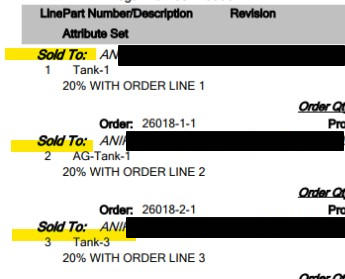

For example, in effort to figure out why this line prints conditionally in ARForm:

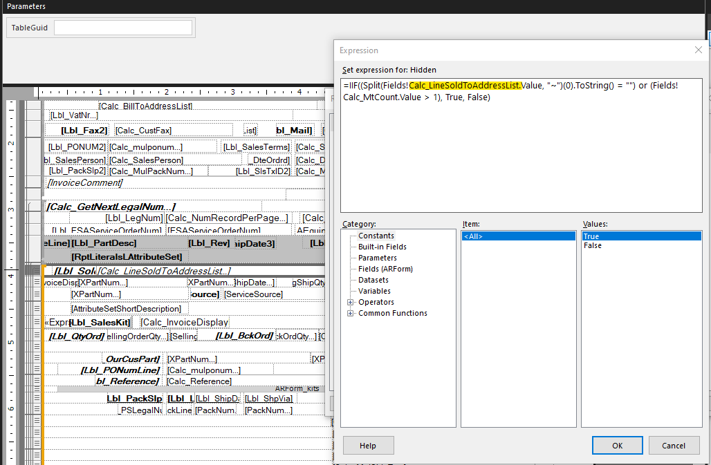

we find it’s based on a calculated field called Calc_LineSoldToAddressList
Okay, well why does it print on some invoices but not others?
Some invoices have a value in that field and some don’t.
Okay why?
That’s where I’m stuck.

Thanks Gabe. That’s a lot to digest but I think I gather the key is this line:
if (!string.IsNullOrEmpty(altCustomer.BTName))
Some Customers have this and others don’t. Those that do have a value in the RDD field and print that line on the report. Even though the Customer, thus BTName, does not differ across all lines. Seems like the intent would be to print only if it’s different. :man_shrugging:
EDIT: I wonder if this is a bug introduced with the relatively recent Consolidated Milestone Billing option on the Customer record. This ARInv is an ADV Milestone billing marked consolidated.
