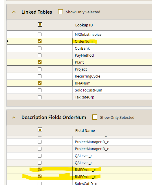

The reports work fine in 2021.2. In our customized ARForm RDD, a couple UD fields are selected for the OrderNum Linked Tables / Description Fields.

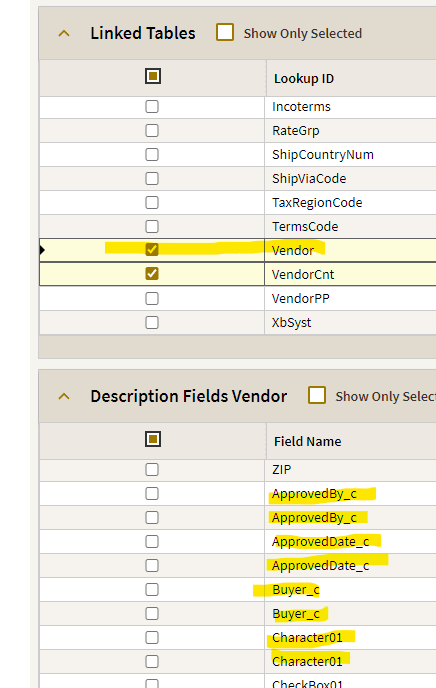

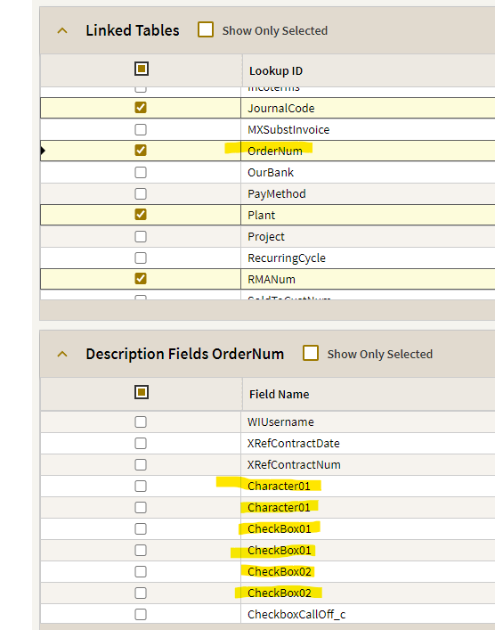

But those fields are failing in 2025.2, giving Invalid Column Name error in System Monitor. The only thing I see different is that on ALL the RDDs, on ALL linked tables, ALL the UD columns are duplicated / show up twice in the Description Fields list!
ARForm (default/system RDD):

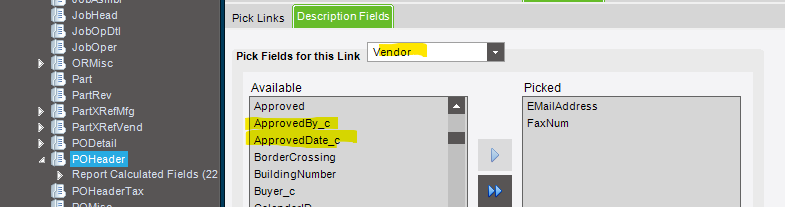

POForm (default/system RDD):
Are yall seeing this too?
Though here is a custom PO form in the classic UI in 2025.2. The duplicates don’t show up. So maybe it is just a Kinetic UI bug and my issue is something else…

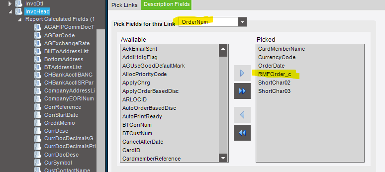

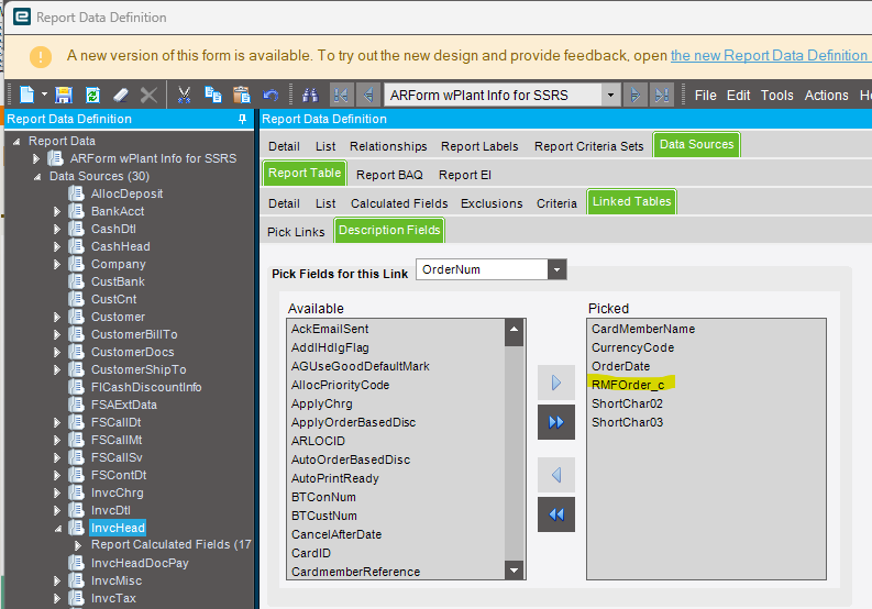

    2021.2 and 2025.2, 2025.2 classic RDDs (no duplicate shown).
