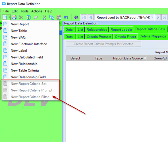

I have read some threads on this forum that mentions how to pass BAQ Parameters into a SSRS Report. It mentions about modifying Report Data Definition (RDD) and then adding the Report Criteria. For me, this area is completely greyed-out. If I try to Duplicate the existing RDD to a new name, it throws me an error “Record not found”.
This is version 10.2.400 and I have all the necessary permissions. What am I missing?
Try closing the RDD Maint window and then re-launching it. Sometimes the UI gets out of sync if a referenced DB record (like the BAQ ID your RDD uses) has changed.

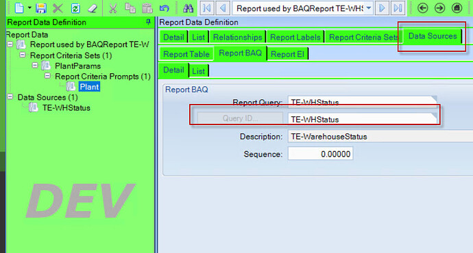

Can’t tell from your screen shot, but have you already added the BAQ as a datasource? I don’t think the Criteria options are enabled unless the BAQ has parameters.

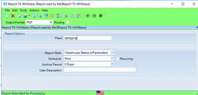

Thanks, I am getting closer but still not there. You were correct about adding the “DataSource”. When I added that, the Report Criteria had shown. I filled everything out. When I run the report from the Menu, I do not see any place I can enter the Parameter Value. The Report Errors saying “No Records Found” probably because the BAQ has an un-passed parameter value.

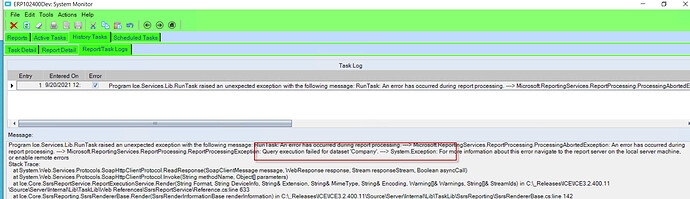

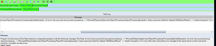

Yes. I did that. I now get a dialog window to appear when running the report, but get SSRS runtime errors.

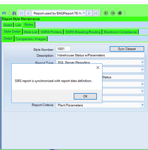

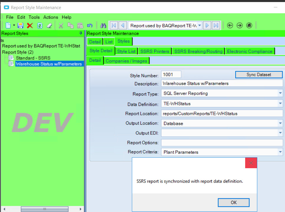

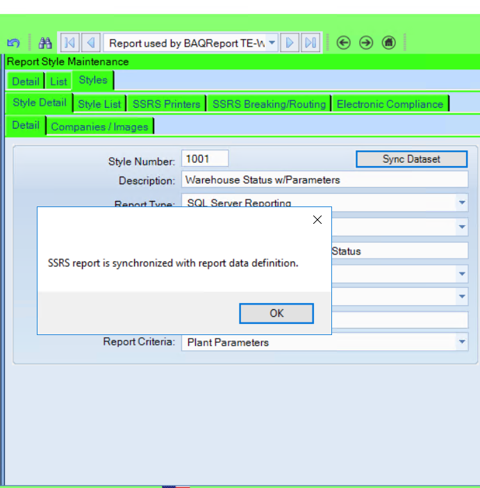

Make a backup of the RDL used by that style, then press the Sync Dataset button.
Normally I would say to NEVER press that button. But looks like you might need to here.
The backup of the RDL was in case the sync process goes horribly wrong - which it often does with built-in Epicor reports
I synced the report and I still get the errors on the DataSet(s). I even opened the RDL and did a Test Connection and Refresh fields on ALL the DataSets.

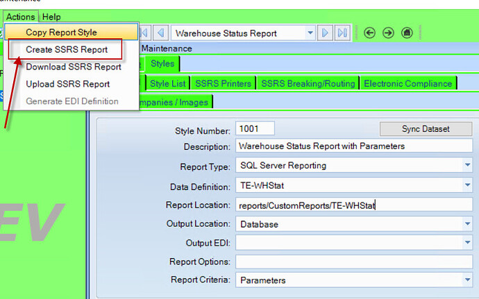

If doing the Report Style, how do I get it build the RDL on the Report Server to edit it?

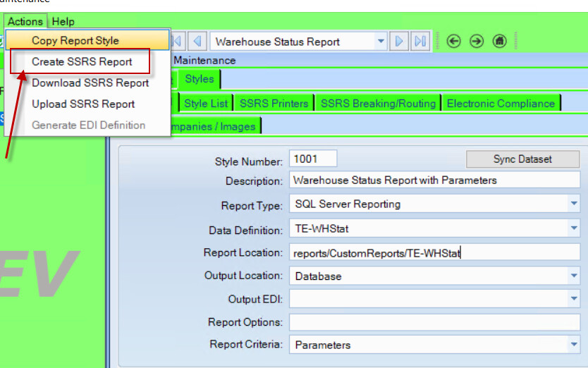

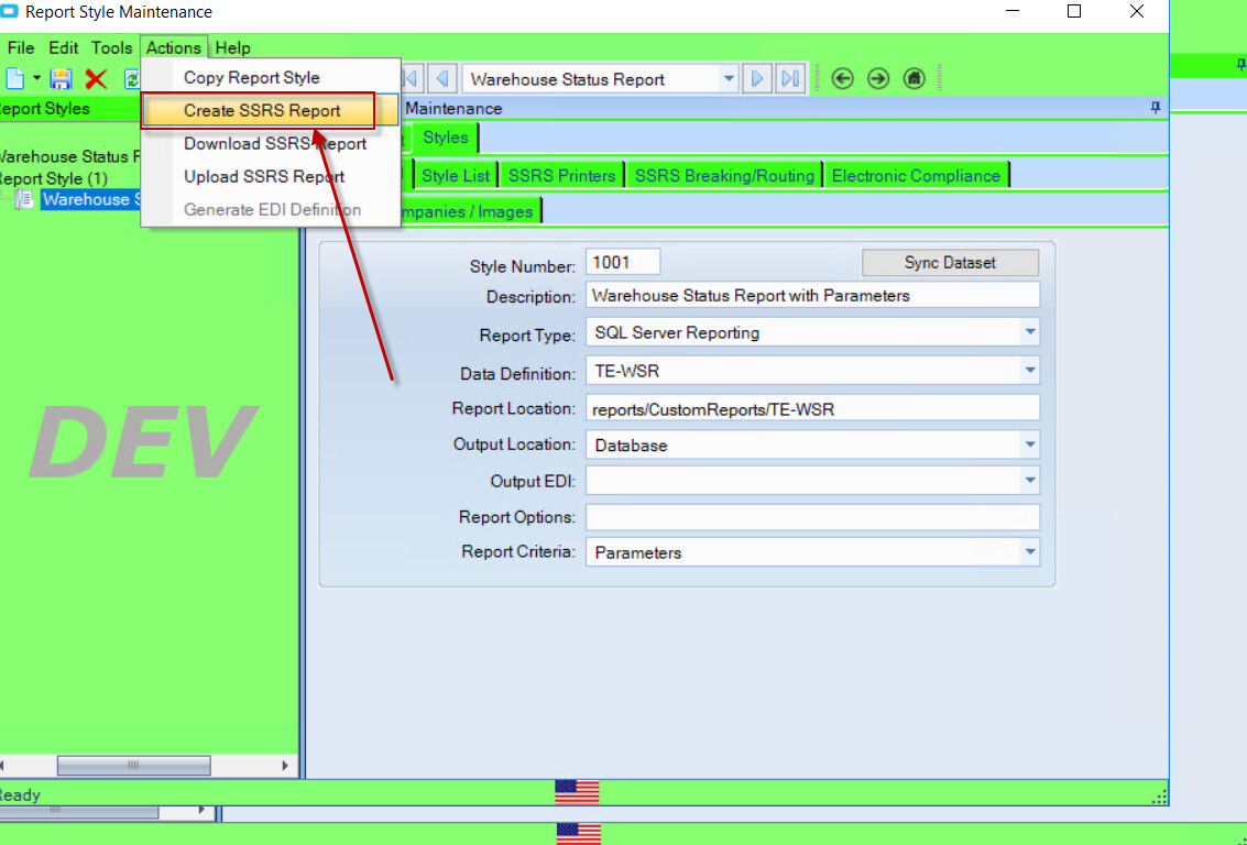

If I do Create SSRS Report, it throws me a permissions error even though I am a System Administrator on the SSRS Site.

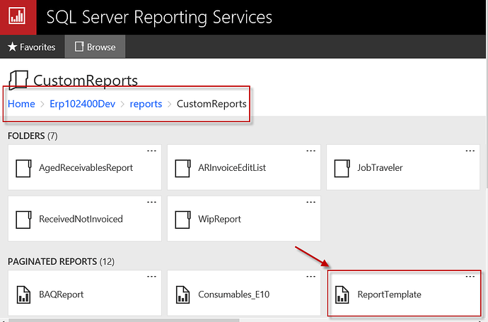

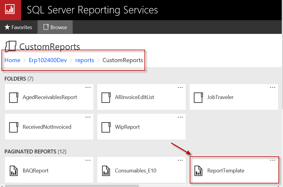

Do you have the “ReportTemplate” in your Custom Reports folder?
Yes. The RDL called ReportTemplate is located in the Custom Reports folder. Within the Report Style, Actions. Create SSRS Reports it throw me a permissions issue. I am a System Administrator on SSRS and can upload reports to that Custom Reports folder just fine if I use the BAQ Report Designer. I can also manually upload and download RDLs to that folder without any issues.
The permissions granted to user DOMAIN\USER are insufficient for performing this operation.
—> Microsoft.ReportingServices.Diagnostics.Utilities.AccessDeniedException:

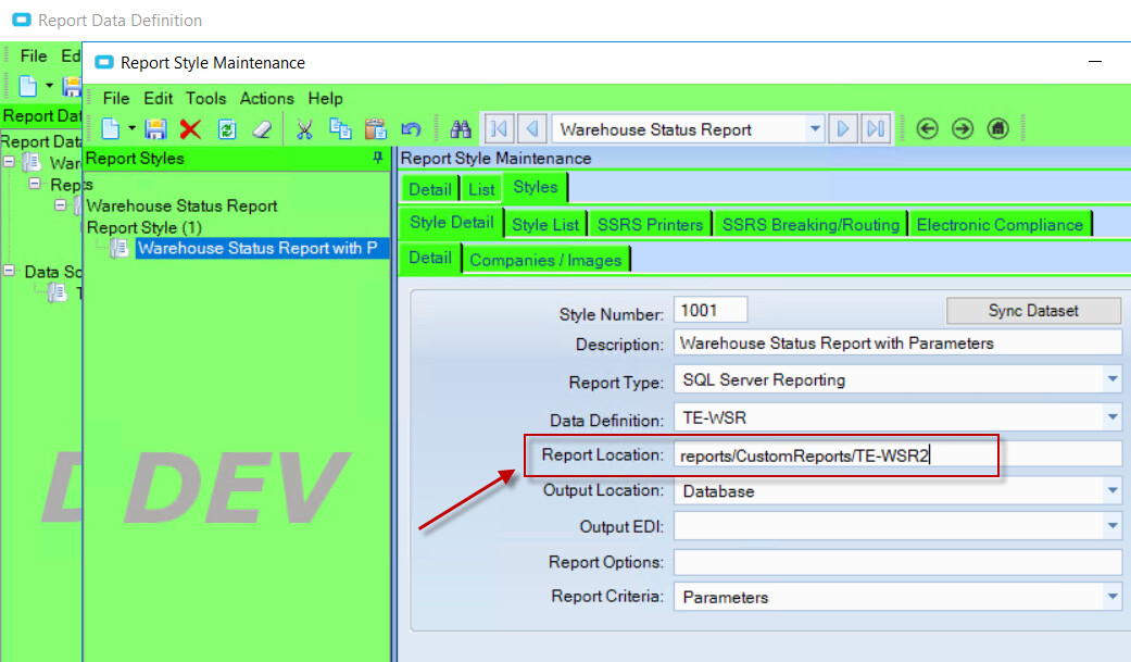

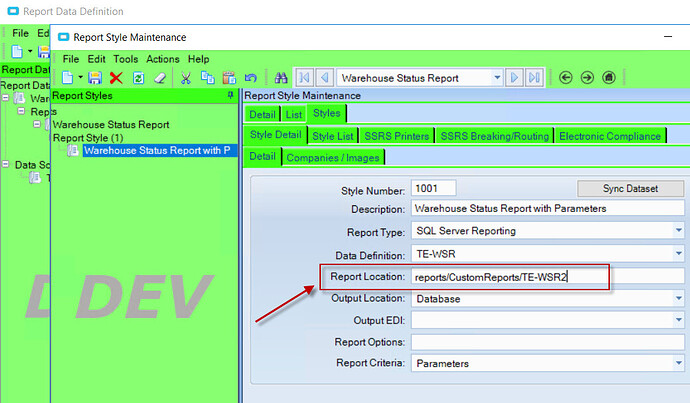

Does an RDL for TE-WSR already exist in the reports/CustomReports “folder”?
Try entering reports/CustomReports/TE-WSR_2 for the Report Location before doing the “Create SSRS Report”
Yes, the file already existing but only because I did this – I downloaded the ReportTemplate.rdl and renamed it to TE-WSR and then manually uploaded it. I thought I could do the Sync Dataset, but that errored.
I just tried your suggestion of making a new Report Location with a different name. Then clicking Create SSRS Report throws me the SSRS pemissions issue.
Based on the Help, I am thinking that the “Create Report” only works for a BAQ Report.
