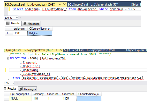

I added a UD field ( ICCountryName_c ) in orderel table, the field holds country description if its intercompany sales order.
In my material queue report, i want to show this country description. Therefore, i added orderhed, orderdtl, orderrel table to the data definition.
when i generate the report, system not showing the UD field (ICCountryName_c) value , when the value does exist in orderrel table.
How can I make it work?
(Note: Data model is regenerated, client cache cleared, 100% sure that i am querying the right table from the reports db …)
Make sure that the SysRowID column is not excluded from the OrderRel table. We need that to hook up to the UD table and retrieve the column value. I believe this is fixed in 10.2 to auto-magically include the SysRowID column.
Ahh,… foreign key. thanks for the reply Jeff. dont know how i missed it.
