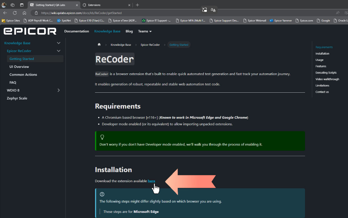

Havn’t seen the Starter Kit download but the extension is still here:
and the doc says this:
If your application uses Kinetic 2024.1(UXP 11.x), this WDIO 8 starter project is
expected to work flawlessly.
l If your application uses a different version of Kinetic, some web elements might
not work if it has been changed as part of application UI. If you encounter this
issue, please reach out to us [DL-TestReCoderAdmin@epicor.com] and we’ll
provide the artifacts for your application version.

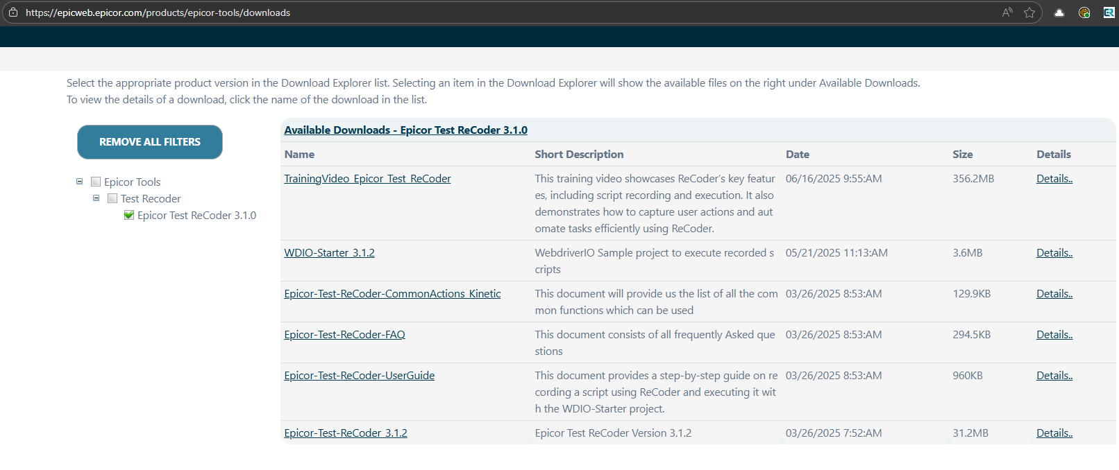

In EpicWeb there is an Epicor Tools section in the product menu. Do you have access to that area? That is where ReCoder is located.
I do see it there. It appears to be one release behind as my extension is at 4.0.
But I imagine that is upwardly compatible.
Now, I wonder why a search of EpicWeb found no matches for “ReCoder”… :thinking:
I never did like the search on EpicWeb. :grimacing:

I’m working on a side-by-side of Webdriver.IO and Playwright.dev for our 2025.2 launch. I want to use these scripts for software validation as well as testing patches and upgrades in the future. Of course, this only runs tests in the browser and not classic. I’m ankle-deep into Playwright so far but couldn’t work on ReCoder until Ben pointed out this download. The video on EpicWeb is very helpful and similar to the presentation I saw at Insights 2025.

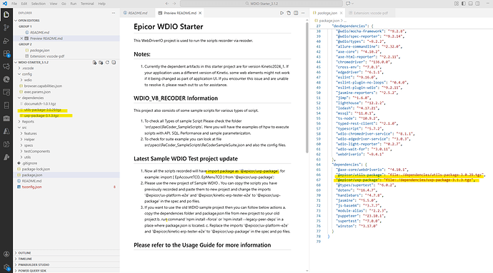

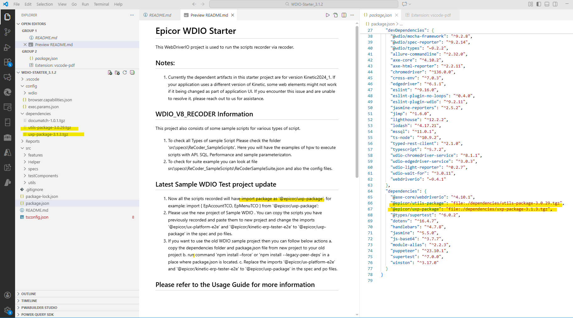

Looks like the Starter does have swapable dependencies so those are probably the artifacts you need.
