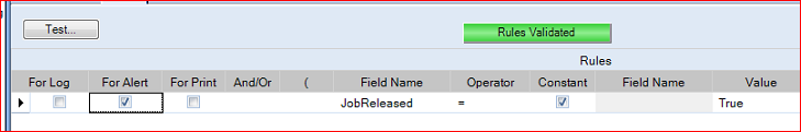

For the alert you can do a BAM for a Jobhead record released with those fields empty. With a BAM .p you can gather any other data you need for the email.

I did a simple BAM on JobHead with the JobReleased = True. In the BAM check for your fields in the If CheckBox16 = True. You can add a find for the PartRev record and email what is correct or missing from the data.
Alert procedures are run from your servers Server\ud directory
JobHeadSample.p (2.1 KB)
