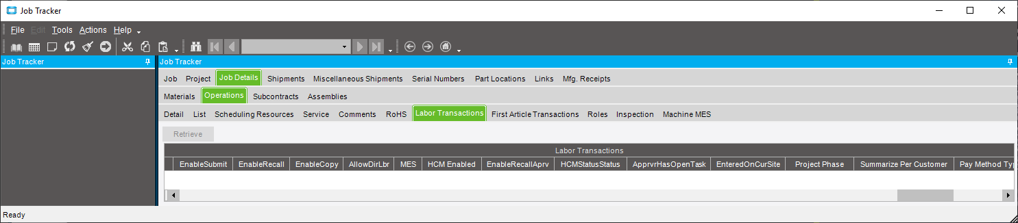

Just wondering what the Status was of the T&E Entry for that Job that you couldn’t Recall? Also, did you try opening the Labor Transaction record against that Job in Job Tracker and look to see if maybe it was still showing as an ActiveTrans?
I’m not really sure where these fields are coming from (I’m sure someone way smarter than me can probably tell you) but I just observed that these columns (EnableSubmit, EnableRecall, etc) were in the Labor Transactions tab:
When I search the help it lists these fields in the Labor Transaction Role Code Edit topic…
I thought this post was related to something similar that we experienced so I just started looking around. Not sure that’s much help but just an interesting observation I wanted to mention…
