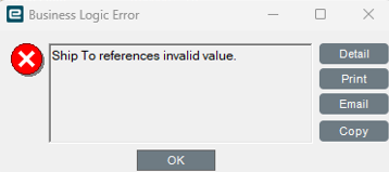

Receiving Drop Ship Error - "Ship To references invalid value"
Since upgrading to 2024.1.10, we occasionally see this error when receiving Drop Ship items.
It’s not a data or method directive. No mention of this error on EpicCare (or even here). Has anyone else bumped into this one?
