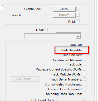

You could mark the part as “Web Saleable” in the part master and only include those parts in your BPM
Yes we do that.
