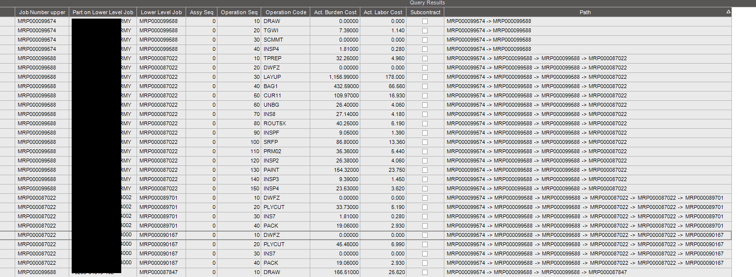

Hi. I finally got my query working but now I have a sort of different problem. It works too well :melting_face: It shows me all the operation costs for all the jobs that go into the job number I enter (all our parts are made to stock with the lot number = the job they were made on so that’s the link I use to drill down) but I don’t get the information for the top level job I enter as the parameter. I feel like I need one more subquery but I can’t figure out how to enter it. Should it be an innersubquery or a CTE? How do I link it to the rest of the results. I am still a bit shaky on how this works.

We use the job number a part was made on as the lot number to maintain some sort of link since all our parts are made to stock. This is what I get. In this example it’s missing the data from MRP000099574 (the parameter I entered)
Ahh.
Are you able to get the costs of the Parent Part using the top query? The top query is the anchor part of the recursion. Looks like you created the top with the first child attached and then did a recursion on the child vs the parent.
I am interested to learn how the Lot Tracking with the job number is working for you. We discussed this as a possibility at one time but ended up not implementing at that time. But its still definitely a need that we have as far as trying to track all the way down to the lower subassemblies.
Regarding your query, you may need to make another unionall after your top query that will bring in your top-level costs. I’m not exactly sure if it maps the same but I have done this to get an exploded MOM with operations and parts and to get the top level operations to show up I had to put it as a unionall to the top level query (because you don’t want to bring in the operations in your recursive part).
Agreed.
CTE for Jobs only Parent \ Child levels
SubQuery for Operation Costs by Job
Join CTE to SubQuery
I’ve decided to just make a separate BAQ to pull the information just for the top level job. It’s going on a dashboard with 3 other baqs all pulling information from the same job, so now I can subscribe those to the job number entered as the parameter and not have to enter the same job number 3 times as a parameter if each query.
It works great having the lot number be the job number. All our parts are made to stock then issued to an upper level job. With the lot=job we can find out what job the issued material was made on right from the top level job tracker screen.
