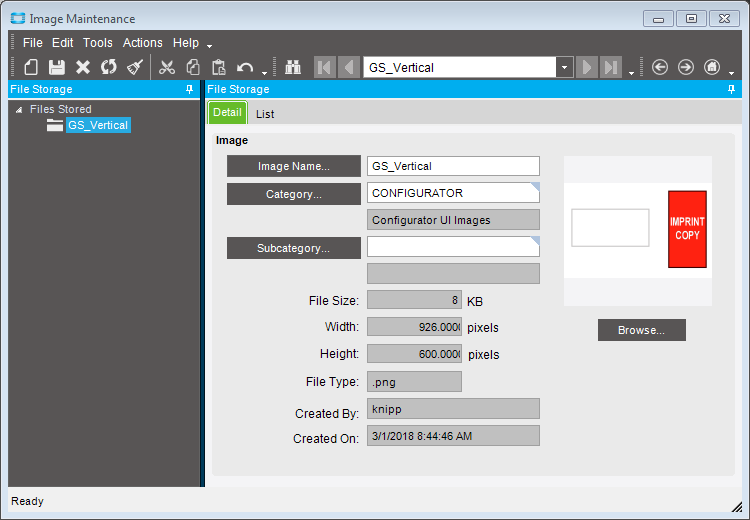

I am trying to reference an image when a text box matches the name of it. I have images that indicate layout of a part.
My Code that references this:

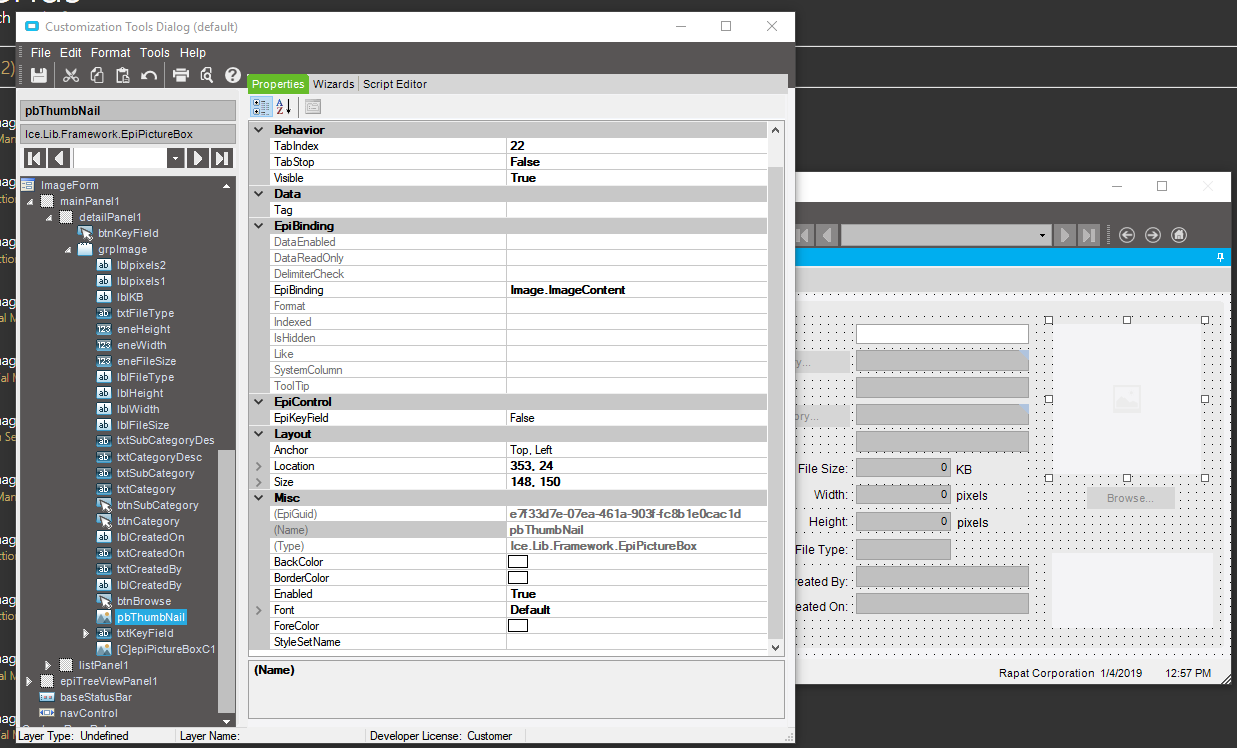

in the tools is an epipicturebox. That’s what the screen that you show is using. Can you just use that and bind it with the properties that the stock ones use? (I haven’t done it before, but that’s where I think I would start.)
edit : that looks like what you are doing.

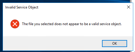

Interesing, when I try to open the image adapter dll I get this error.
Guess the BL test can’t play with images??
edit: I needed to open the contract.BO, not the adapter.

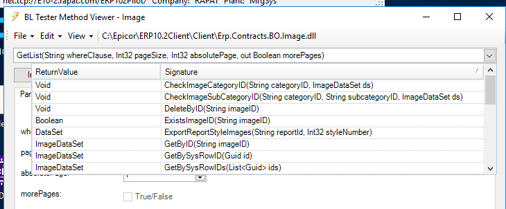

Here are some of the methods that go with that adapter.
so you should be able to check for whether it exists using ExistsImateID(string ImageID);
Then if it exists, get the image. I’m not sure what exactly I’m looking at so I don’t know for sure where to go from there.
I bet if you look at a trace when you are switching, you can get the method calls from there.
