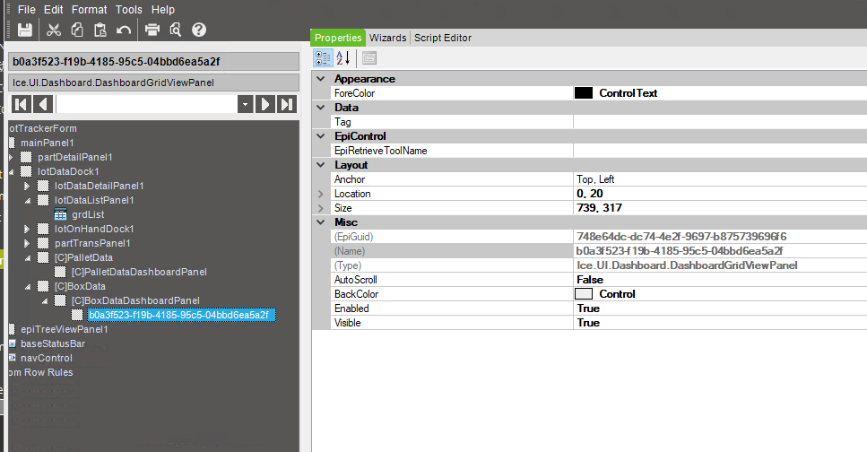

I’m sorry if this has been posted before, however I was unable to find anything about this. I would like to reference a value in a cell in a dashboard grid that was added to a screen through a customization. The grid is an Ice.UI.Dashboard.DashboardGridViewPanel. I’m familiar with declaring an EpiUltraGrid and extracting values from those, but this seems different and I’m unfamiliar with how it is done. I’ve also looked in the Epicor Customization Guide and found a section about getting data from Dashboard TrackerViewPanels, but this also seems to be something different than a dashboard panel added through a customization.
If anyone could give me a suggestion or point to any information related to this it would be appreciated.

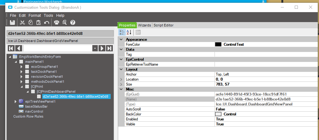

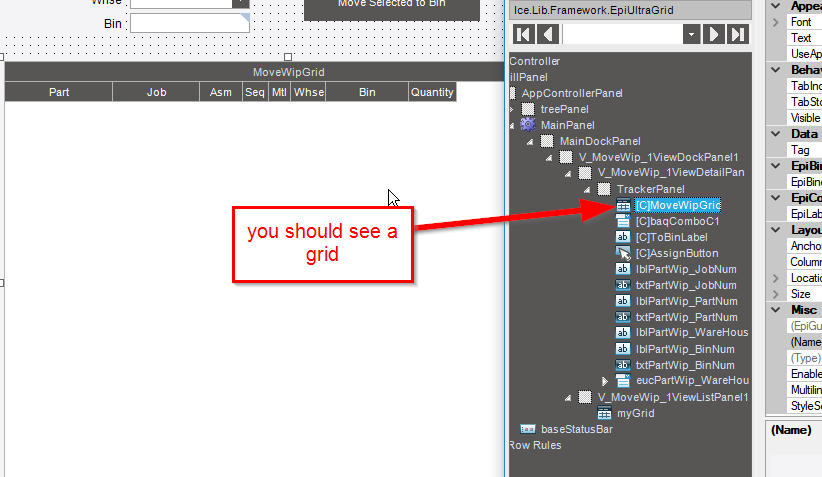

There used to be a bug where you can’t get to a grid in a dashboard customization (the tree just stops) but I’m that was fixed before your version. I’m on 10.2.200.13.
Can you show me a screen shot of the tree in the customization?

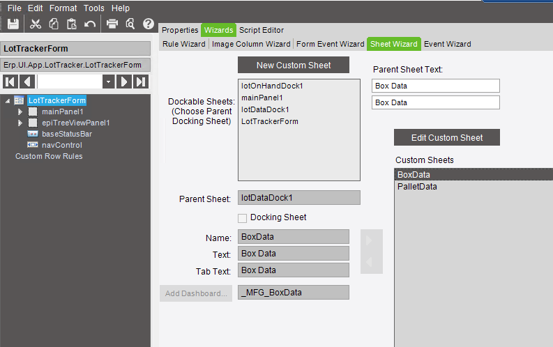

Could you elaborate on that some, I’m not sure I fully understand. I believe these were brought in by the sheet wizard. I tried to bring in the dashboard again, however I had the same results.
Mine shows up the same as yours. I’m wondering if the same bug that I had in the dashboard customization is showing up here. To get to it, you will need the giud of the grid, which you can’t get if it doesn’t show up.
I’ve never tried to pull data from a grid that I’ve brought in that way, so I hadn’t noticed this yet.
