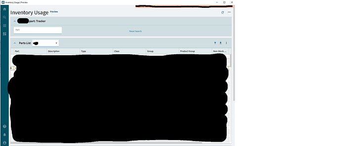

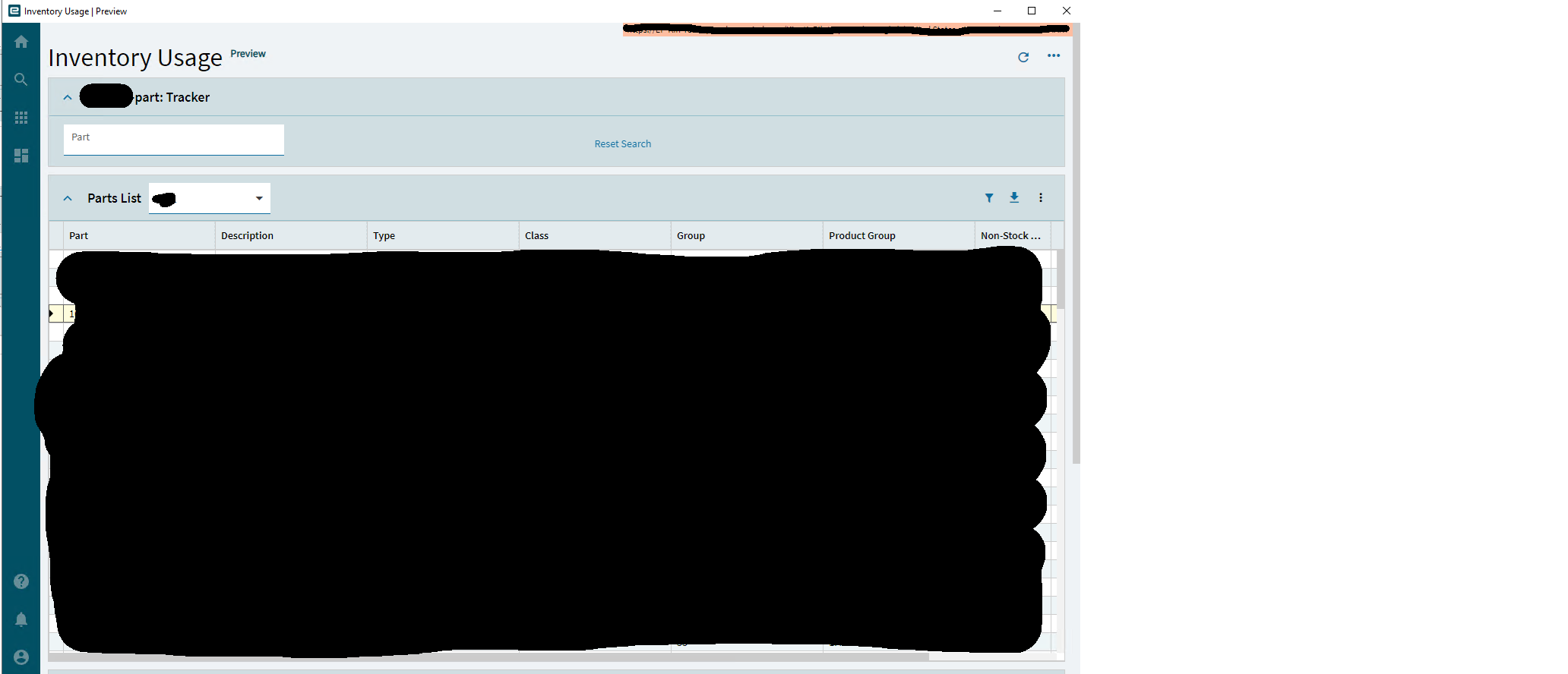

I am running into an issue here where I have a Dashboard with an EDD Graph at the bottom. I have tried to wired up so that the EDD Graph will refresh whenever I select an Item within the grid Parts List. This is an Uplift from a Classic Dashboard to a Kinetic Dashboard
I setup my BAQ to have a BAQ Param @GPartNum and the intention is to Pass the Part selected in Parts List to the Graph inside Inventory Usage

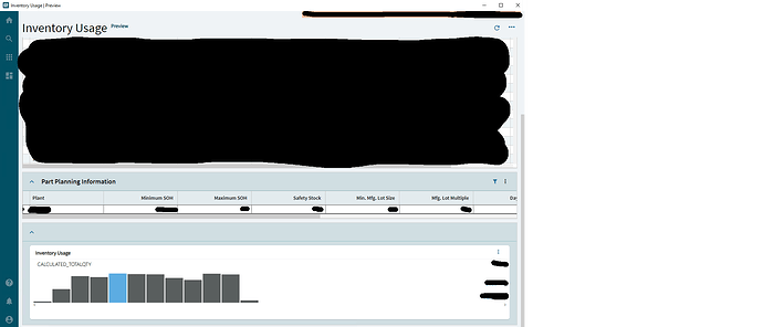

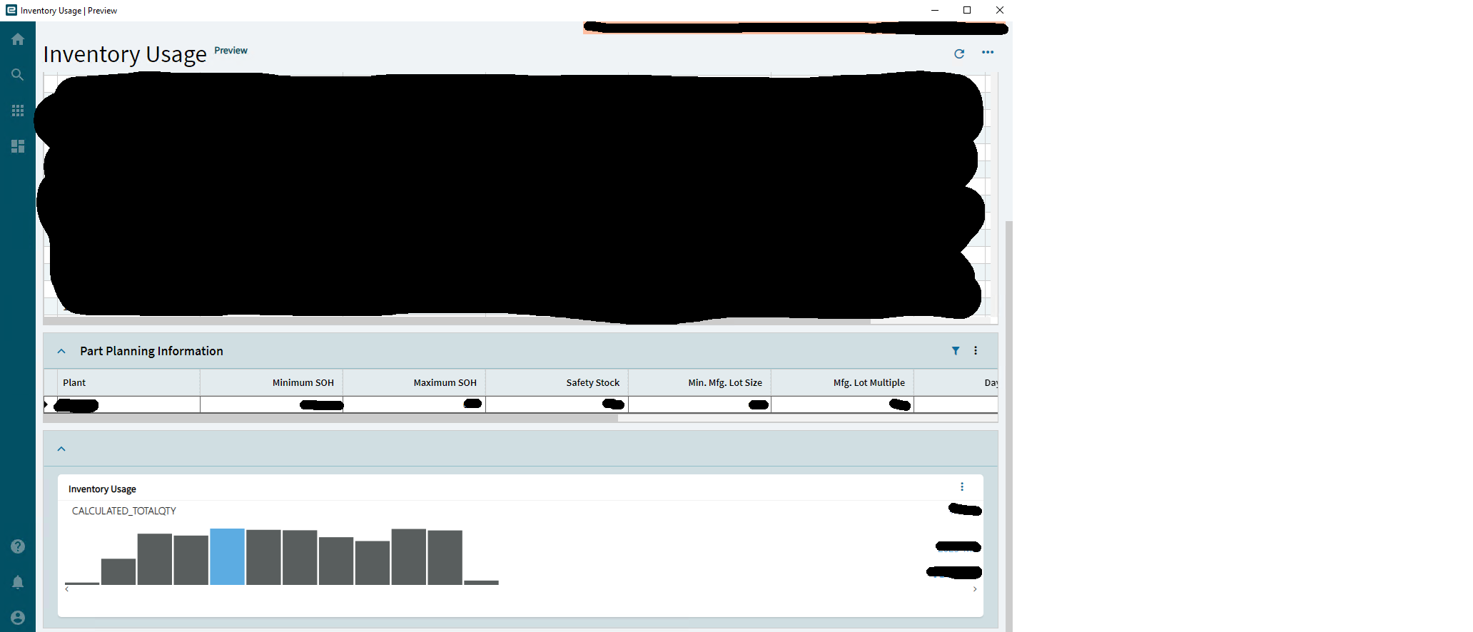

The issue I am running into is : Whenever I select an Item inside the Parts List Grid, the Inventory Usage Graph never updates

The Data Discovery Chart widget does not re-query with filtering when driven externally. Unlike grid widgets which use whereList with TransView bindings in layout.jsonc, is Data Discovery Chart is stored in Epicor’s database as an EDD object? Does it have no equivalent binding mechanism exposed in the JSON layer? The TransView value is confirmed being set correctly, the BAQ filters correctly standalone, but the chart widget ignores the filter.
