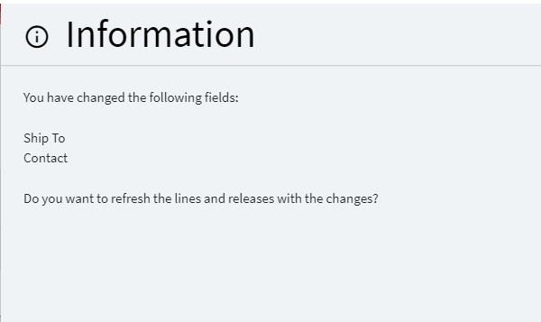

I have a Windows 10 machine that is not asking the below question when a ship to is changed on a sales order. I can go to a different machine and use the same login and it asks the question. Has anyone encountered this before or have an idea of how to fix it?

It’s simply a new feature, when you change the Ship To or other fields on the order you get prompted if you would like it to automatically update the lines and releases. Your choice yes or no. No fix needed.
Correct. My problem is I am not getting the prompt on one of my users computer. Go to another computer and login that same person and it does give the prompt.
