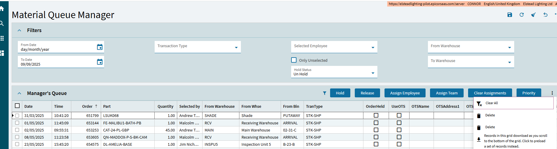

Hello, I am finding the new way of downloading all records on material queue manager to be a bit of a pain is there no way to always auto load all records instead of remembering to click this button

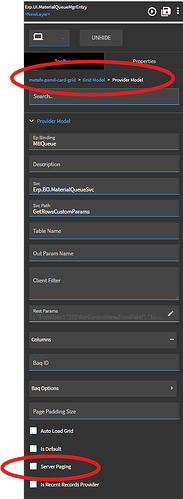

Normally you can control this in Application Studio by change the grid to Disable Server Paging:
However in this case (as of 2024.1 at least) this is already disabled and mine does the same thing so it seems this grid is working a little differently than most other (all of them that I have encountered thus far TBH).
