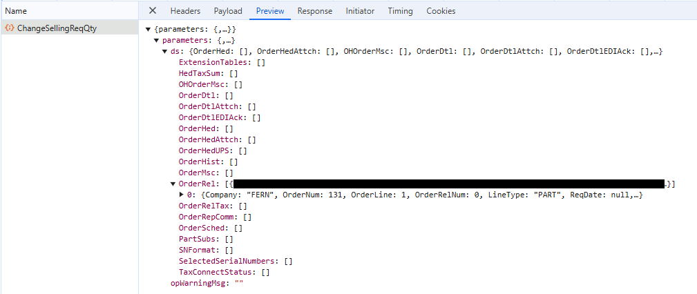

Dev tools shows an event called ChangeSellingReqQty being fired when I change the release quantity. So I go to add that event and trigger something after it, but Application Studio doesn’t show it in the list of target events.

I believe what you are looking at is a Method, not an event in Application Studio. Events show up in the Console window after you enable debugging mode (F12 to open the trace window, click into a data field on Kinetic, press Ctrl+Alt+8 to enable debugging mode). Methods should up in the Network tab, App studio events show up in the Console tab.

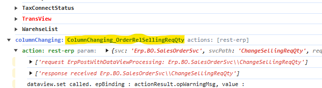

You absolutely nailed it @mackenziem !
The target I needed turned out to be ColumnChanging_OrderRelSellingReqQty and I found it in the Console tab with debugging mode on.
