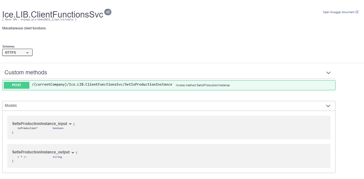

You might try the ClientFunctionsSvc:
That’s the ticket, works like a charm. Thank you kindly.
