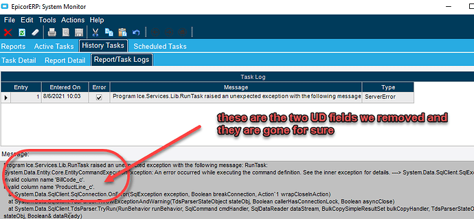

Help - we removed a couple unused (we thought) UD fields from OrderHed and now our Order Acknowledgement report does not work. We can’t seem to find these fields anywhere in the report style or on the report. How do you track down where this is coming from?

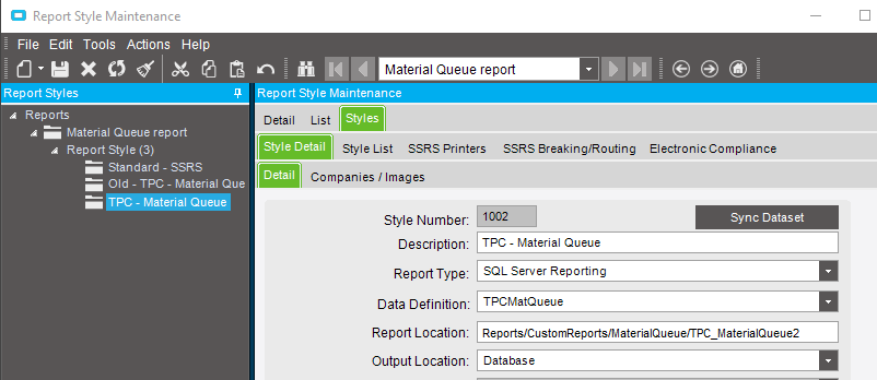

Go into the report style of the affected report

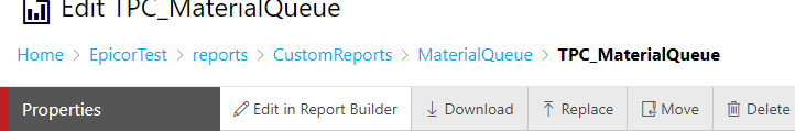

Find the report in your SSRS manager and click edit

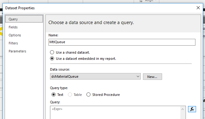

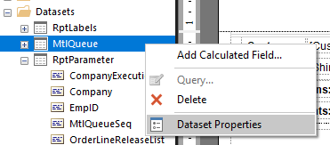

Once you have opened up your report, find the main dataset (or even all could contain the fields you removed) and right click properties
Find the SQL query that the report uses to query the temp tables in the bottom right button
Make sure you do this for all subreports that are in the main report as well
