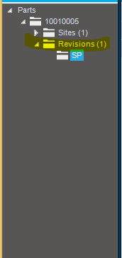

Dear Team,
I trying to rename the left side panel tree name Revisions to Owners but, not able to rename it. i’m tried the following codes and put on initialize() method.

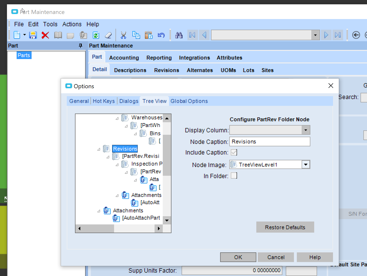

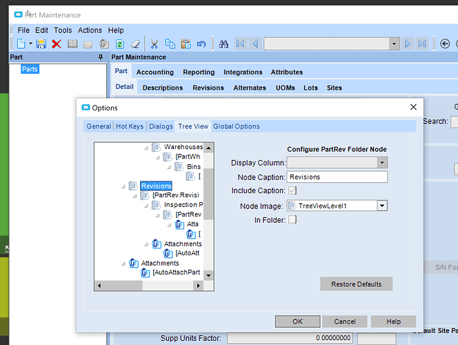

You can do that without needing custom code.
Goto tools -> options in the part entry screen to see below dialog
edit the revisions Node Caption to what you want.
I think you will need to open the part screen, make the edit, then hit tools -> customisation to bring the edit into the customisation and then save. I know this works for the window location because when I save on my 2 screen setup the users can no longer see the window.
Brett
Dear bmanners,
thank you. its working now.
