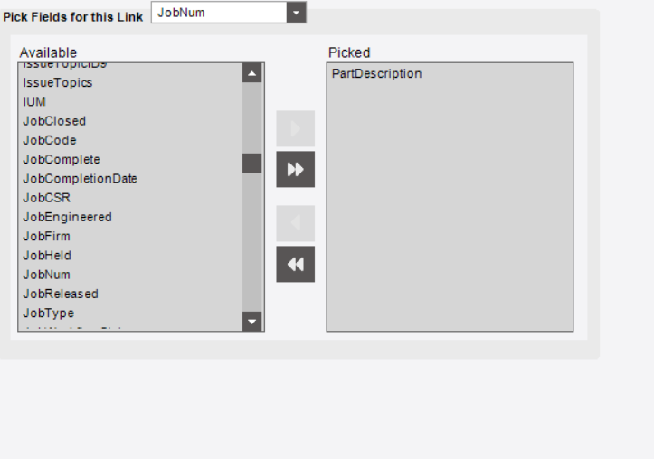

What table did you add?

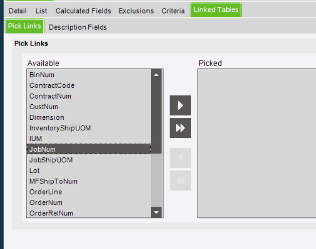

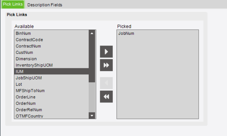

Use Linked Tables.

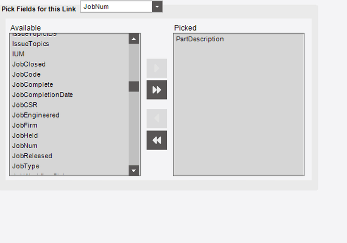

JobNum is available. You should be able to select your column, no join needed.
Picked
Your syntax would be under T2.Calc_WeightUomDflt
T2.JobNum_MyColumnName

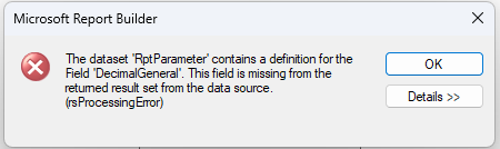

Thanks for the response.
I was able to get data output with that combination but still run into an error when trying to view the ssrs report (seen below). Honestly I’m at a loss because that part of the report is not being touched. At least I am moving in the right direction. Thanks for the help with the previous issue…
