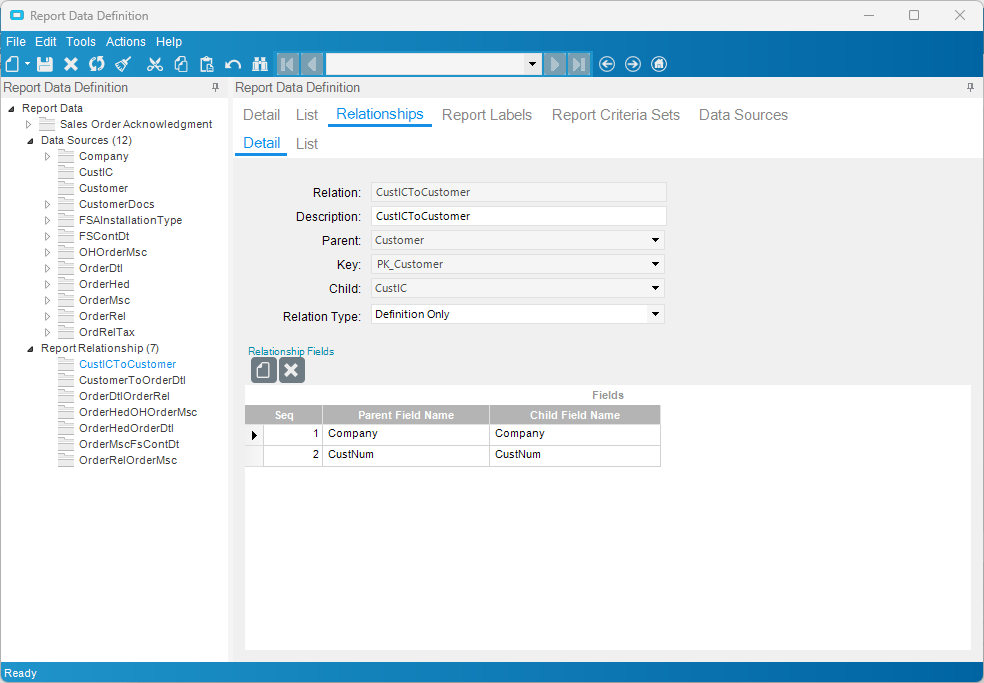

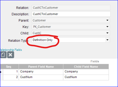

Change this to Output:
You need data from the CustIC table… so you need this relationship to “output” data.

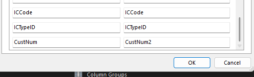

  • did you add the fields in the SSRS field list after you updated the query? In dataset properties, go to Fields section and press Add
Thank you for this i have changed the T6 part to the below
T6.Company as Company2, T6.CustNum As CustNum2, T6.ICCode, T6.ICTypeID
Yeah i have them in the Fields, still nothing
I have also tested it by removeing the company&CustNum from T6. all let the report run but it doesnt bring back the T6 info

Did you add it in as a join on the RDD and RDL? ShipToID = ShipToID
The ShipToNum is only on the CustIC table so not sure thats possible?
Then join it to OrderHed (or OrderRel if you change the ship to at the release level).
